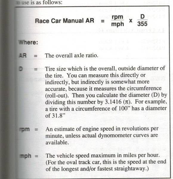

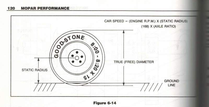

here is some food for thought from the old Mopar Chassis book
One thing you have to get your arms around it the aero drag once the car is moving..it is huge and is probably the most misunderstood factor in the whole project.
Please check into drag coefficient...

Just a note on the first of your thumbnails: for street tires, the free diameter is the number to use. They don't grow like the slicks used in the higher classes.
