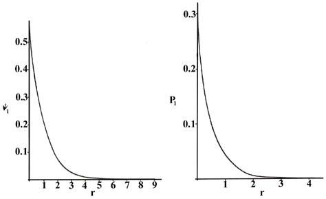

How do you distinguish "inside" versus "outside" for e.g. the ground state of hydrogen, for which the electron probability density as a function of r looks like the right-hand graph below? Do you mean "r large enough that the probability density is negligible"? (It never actually reaches zero.)
Two line graphs: left, psi_1 against r, starting near 0.55 at r=0 and decaying toward zero by about r=5; right, p_1 against r, starting near 0.3 at r=0 and decaying toward zero by about r=3.
(source: http://www.chemistry.mcmaster.ca/esam/Chapter_3/section_2.html)
Both the potential and kinetic energies of the electron must also be described using probability distributions. Their sum is of course a fixed number: -13.6 eV for the ground state of hydrogen.
