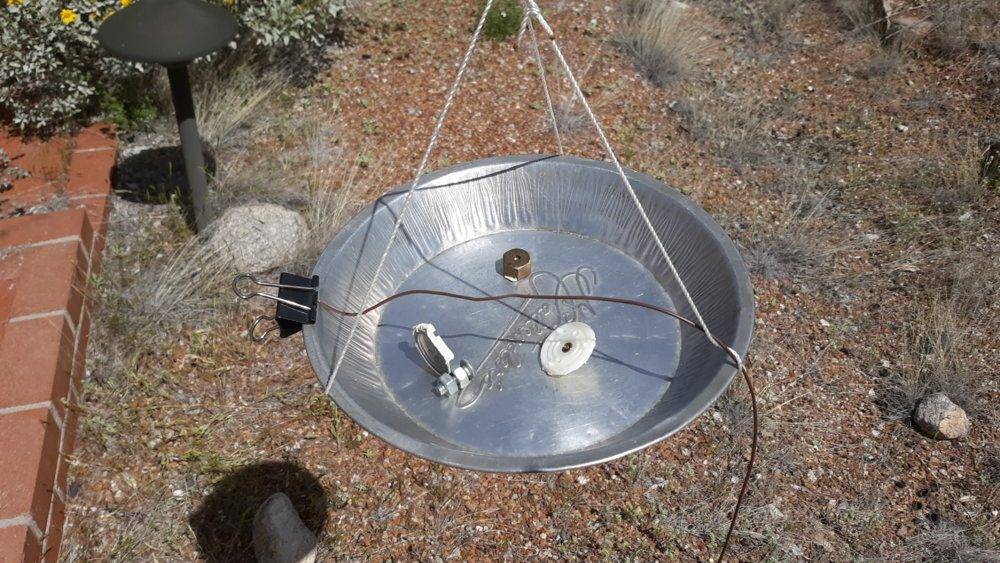

Fishing for atmospheric electricity.Three microcuries of Am-241 were placed in a aluminum pie tin.

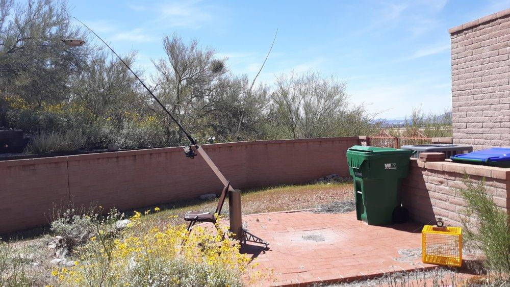

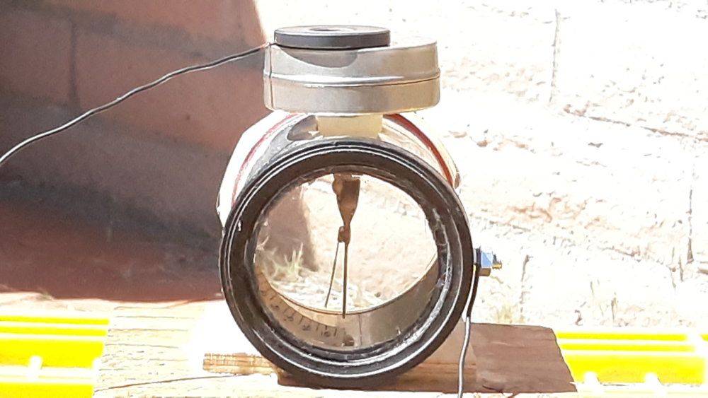

The pie tin was then suspended 2.7 meters in the air by a fishing pole. The pie tin was insulated from ground by the nylon fishing line. A wire connection was hung from the pie tin to the top terminal of a gold leaf electroscope. The outer case of the electroscope was connected to Earth ground.
The first reading was at 11:43 am MST and based on the gold leaf deflection, represents a voltage of about 100 volts giving a field strength of 37 volts per meter.
The next reading was at 1:10 pm MST and represents a voltage of about 225 volts giving a field strength of 83 volts per meter. This was the highest reading I got. Strong winds made me stop the experiment.
These field values seen low and this might be due to my backyard being in a depression with the terrain sloping up on two sides. I might try doing this experiment in my front yard were the terrain slopes down on two sides. If the neighbors see this however they'll probably think I'm a nut job.

The humidity was about 30%. This is the first time I got this experiment to work after about eight failed attempts. I found the cause of these failures to be poor insulation of the pie tin and the insulation of the wire from the pie tin to the electroscope. I ended up having to suspend this wire in air between the pie tin and electroscope.
