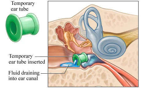

Here's another example. To treat an ear infection it is sometimes necessary to place a tube in the ear to promote drainage of fluid trapped behind the ear drum. What does that tube do? Does it allow atmospheric pressure to enter the ear and push the fluid out? Or does it allow your Eustachian tube to suck it out?
I suppose you'd say it's a semantic difference, but without the atmosphere pushing on the air in the inserted tube the Eustachian tube would not be able to "suck" the fluid out, making the inserted tube useless.
Herman Trivilino said:
Describing it as sucking the fluid glosses over that fact and students don't get an understanding of what it means to "suck".
Right, that's why I'd teach the proper definition.
You wrote that backwards, didn't you? I think fluid goes out through the inserted tube, not through the Eustacian tube.
Anyway, the main reason the word is used/useful is it describes the goal or which side of the device is the main point of the device. You stand in front of a fan (blows) and behind a vacuum pump (sucks). It's a single-word way to describe that.

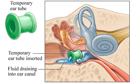

Not backwards but I did get it a bit wrong. The fluid drains out, not through the inserted tube or the eustation tube, but into the ear canal and out of the ear.
Ear tubes (tympanostomy tubes) allow fluid to drain from the middle ear creating a new pathway through the eardrum directly into the ear canal, bypassing the blocked Eustachian tube to relieve pressure and prevent infection. The fluid exits the ear externally, often seen as clear or cloudy drainage, indicating the tube is working effectively.
So rephrasing my original question, what is the function of inserted ear tube? I'm saying that it allows the atmosphere to push the fluid out from behind the drum into the ear canal.
Are you claiming that the ear canal "sucks" the fluid out from behind the ear drum? And that stating it that way is only a semantic difference? If so, what is the function of the tube? And if there were no atmospheric pressure the fluid would get "sucked" out anyway?
I'm saying that the fluid is not being sucked out, which is the entire reason for the doctors to insert the tube. Because the tube provides a path for the atmosphere to push the fluid out.
It's not a semantic difference. It's a correct description of the purpose of the tube.

I mean, that's still pretty much a mess, so you're arguing against your point. The tube is a pressure relief device. Excess pressure in the inner ear is relieved by the tube, allowing fluid to drain out through the tube. The atmosphere isn't doing the pushing (the fluid is escaping TO the atmosphere), the excess pressure in the inner ear is doing the pushing. There's no "sucking" going on.
I'll say again: the reason "suck/suction" or "blow" is used is it's describing an action by a device. The atmosphere is the steady thing that is always/already there, so it's ignored. Then you add a device to make a change and describe what that device is doing. You wouldn't say the atmosphere is sucking fluid out of the ear - that makes no sense. Similarly, saying "the atmosphere pushes air/dirt into a vacuum cleaner(fan)" completely ignores what the vacuum cleaner(fan) is doing to make that happen. That's why it's a less useful/descriptive and more cumbersome way to describe the situation and that's why engineers don't say it that way.

No. The fluid runs out of the ear through the ear canal. Read my post again.

@Herman Trivilino, do you disagree with the illustration? It clearly depicts the fluid to be flowing through the ear tube in order to reach the ear canal.
