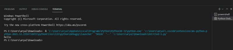

yes looked into it. it shows some weird cmd commands along with output. I will show you a bit.
I just want the output not this weird stuffs. Is there a way to do it?

shivajikobardan said:
I assume you have moved on to VS Code, but it would be helpful for future users coming to this thread if you could also post a link to where you found that screenshot, rather than only the screenshot.
it is from my reddit account.so i don't think it will be appropriate to share that here.
Can you post the response as text? That will have a longer half life.

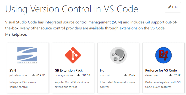

Do you also use VS Code for version control, or do you link to another revision control system?
VS Code doesn't do version control itself, but it does integrate really well with Git (out of the box) and other VCSs (via plugins).

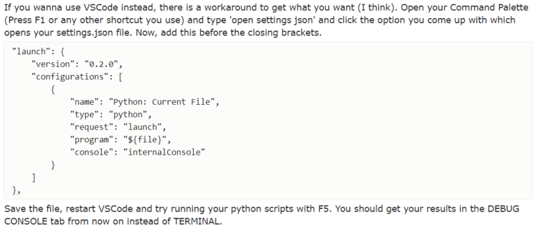

If you want to use VSCode instead, there is a workaround to get what you want (I think). Open your Command Palette (Press F1 or any other shortcut you use) and type 'open settings json' and click the option you come up with which opens your settings.json file. Now, add this before the closing brackets.
[CODE title="code"]"launch": {
"version": "0.2.0",
"configurations": [
"name": "Python: Current File",
"type": "python",
"request": "launch",
"program": "${file}",
"console": "internalConsole"
},[/CODE]
Save the file, restart VSCode and try running your python scripts with F5. You should get your results in the DEBUG CONSOLE tab from now on instead of TERMINAL.

Ah I see. vs code seems less crashing tbh.
