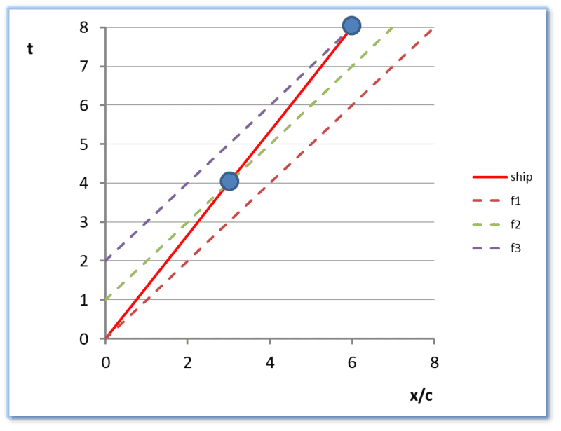

Hill said:
You don't need relativity to answer it. Just kinematics.
What might help is a diagram (see Minkowski diagram) like this:
(everything in seconds):
Flash emitted at earth t=0 has ##x = ct##,
Flash emitted at earth t=1 reaches ship at t=4,
Flash emitted at earth t=2 arrives at t=8 etc.
