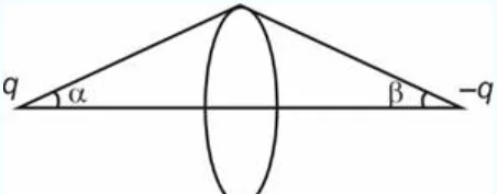

two charges +q and -q are placed on the axis of a ring at a distance 16cm and 9cm from the center on opposite sides. the ring has a charge 2q uniformly distributed on it. find the flux through the ring.
solid angle, gauss law
Diagram of a circular ring drawn as an ellipse, with a point charge q on the left and a point charge -q on the right, with angles alpha and beta marked between the lines to the ring's edge and the horizontal axis.
here is a simple diagram representing this situation. The issue I'm facing with this problem is a matter of sign convention.
We can write the flux through the ring as the sum of the contribution of fluxes due to the point charges individually.
So $$\Phi_{\text{net}} = \Phi_{+q} + \Phi_{-q} $$
additionally I was able to calculate the magnitudes of both of the individual fluxes as
## \left| \Phi_{+q} \right| = \frac{q}{10 \epsilon_0} ##
and
## \left| \Phi_{-q} \right| = 2\frac{q}{10 \epsilon_0} ##
both using a basic approach with solid angles(relating half angle to solid angle).but to get the net flux, should I add both the fluxes, or subtract them?
edit- radius of the ring is given as 12cm

sorry radius of ring is given as 12cm.
also for the flux calculation through the ring I ignored the charge on the ring, As I am unsure how to deal with self flux (if that exists) in electrostatics, and I am kind of confident that this question does not involve those complexities.(given its level)
As for the hint, I would think about the relative positioning of the E vector and A vector, and check for the sign of the dot product, but I am unable to do so.
Then I confirm your results.

In that case I agree with your values for the magnitudes of the fluxes. Though I would write '2/10' as '1/5'!

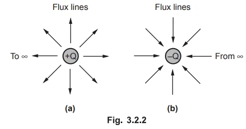

Imagine lines of flux as lines leaving a positive charge or entering a negative charge (image from https://eee.poriyaan.in/topic/electric-flux-11760/):
Fig. 3.2.2: two diagrams of radial flux lines. (a) Arrows point outward from a +Q charge, labelled 'Flux lines' and 'To ∞'. (b) Arrows point inward toward a -Q charge, labelled 'Flux lines' and 'From ∞'.

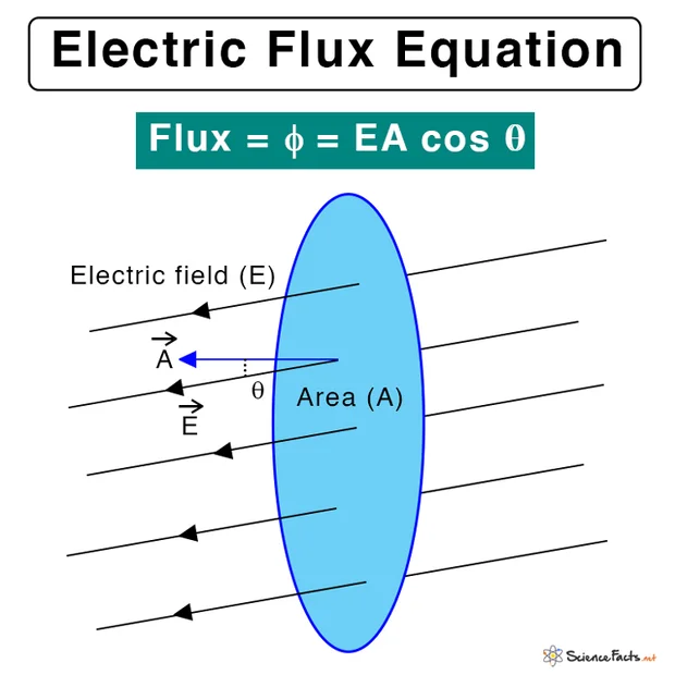

If lines of flux pass through an area. that means they enter from one side of the area and leave from the other side of the area (image from https://artpictures.club/autumn-2023.html):
Diagram titled Electric Flux Equation showing flux = phi = EA cos theta, with parallel electric field lines (E) passing through a blue ellipse labelled Area (A), with area vector A and angle theta between them.
You need to imagine a ring made of lots of individual charges. Visualise the lines of flux from any single charge on the ring. Convince yourself that none of the lines of flux actually pass through area enclosed by the ring. So the flux from a ring of charge, through the area enclosed by the ring, is zero.

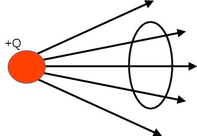

@palaphys, for an intuition, it helps to visualise flux lines. In the following diagram, the magnitude of the flux through the loop due to a charge +Q is ‘3 lines’.
Diagram of field lines radiating outward from a red sphere labelled +Q, passing through an ellipse representing a loop; five lines are shown, three crossing the loop.
For convenience, we can take ‘enter loop on left and leave loop on right’ as the positive sense here. This is equivalent to taking the normal of the loop’s area as pointing right. The value of the flux through the loop is +3 lines.

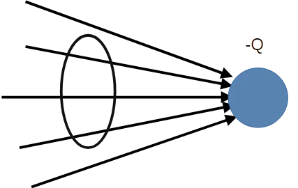

In the following diagram, the flux through the loop due to -Q is also ‘+3 lines’ because the lines of flux are also flowing left-to-right through the loop (in the same general direction as the normal).
Diagram of five black arrows converging from the left through an open oval loop onto a blue circle labelled -Q on the right, representing field lines directed into the negative charge.

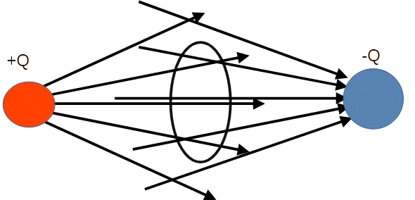

With both charges, the total flux through the loop is (+3) + (+3) = +6 lines:
Diagram of field lines from a positive charge labelled +Q on the left to a negative charge labelled -Q on the right, with a vertical elliptical loop between them that several lines pass through.
If you have flux lines flowing in opposite directions (e.g. with +Q and +Q symmetrically placed on opposite sides of the loop) you would have a flux of (+3) + (-3) = 0. Convince yourself of this if needed!

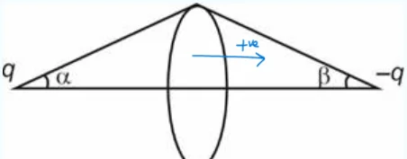

This post makes everything clear. Very high quality. All my doubts on this question got cleared!
for a) I will take the direction of normal as rightward (as shown in diagram)
b) ##\phi_{+q} = \frac{q}{10\varepsilon_0}##
and ## \phi_{-q} = \frac{2q}{10\varepsilon_0}##
c) ##\phi_{net}=\frac{3q}{10\varepsilon_0} ##
(which matches the answer key given.)
