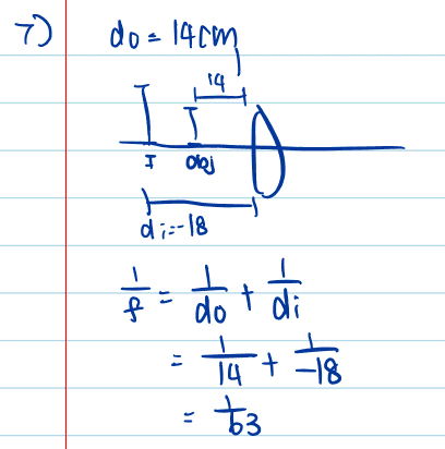

The focal length of a converging lens cannot be 63 cm given the parameters of the problem. The object distance is 14 cm, and the virtual image is located 18 cm from the object, resulting in an image distance of -4 cm (since virtual images are represented as negative distances). Using the lens formula (1/f = 1/v - 1/u), the correct focal length is calculated to be -2.8 cm, confirming that the initial answer of 63 cm is incorrect.

An object is in a distance of 14 cm from a converging lens. The lens produces a virtual image at a distance 18 cm from the object.
What is the focal length of the lens (in cm).
1/f = 1/di + 1/do
I attempted and keyed in the answer as 63 but I was graded wrong. What am I missing?
