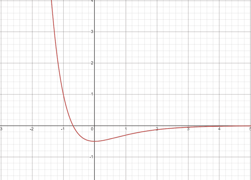

I would suggest plotting the potential.

The plot of the potential setting all the constants to one starts from some value greater than zero, decays to some minimum negative value (which is at x = 0) and then approaches 0. So looking at the potential plot the particle is not going to turn back around unless E<0, otherwise it will keep going towards x = infinity. So following the plot, my intuition would be that E<0 is the condition for there to be periodic motion.
Right. So for E < 0 you get two turning points. That answers part (a). Note that negative total energy means that you have a bound system.
To be more precise: ##-1/2 \leq E < 0##.
The energy is bounded from below by the potential minimum.

E=-1/2 would, I suppose, be periodic in a degenerate sense. OTOH, we are told the particle "is moving", so E>-1/2 is guaranteed.
