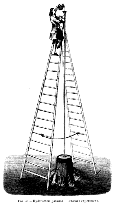

Have those poor souls heard about the Pascal's barrel experiment? :smile:
Either you dive 10 meters below the surface of Lake Ontario or 10 meters below the surface of a small water well, each one of your tympanic membranes will feel a pressure that is equivalent to 2 atmospheres.
Multiply that value by the area of that membrane that is in contact with water (or trapped air), and you will have the value of the uniformly distributed force that that column of water is exerting over each membrane.
