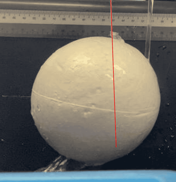

kuruman said:
That concerns me too. I suspect that the flowing water exerts a torque (it's viscous after all) that rotates the sphere about the point of support at the screw.
haruspex said:
That's why I doubted the centre would lie on the line of the string, but I'd not expected the effect to be as strong as shown in the picture.
I was thinking with as thin as that flow is around the sphere pressure gradients should be very small in any direction, but baffled that there apparently is this torque!

Another piece of information that we lack is exactly how @printereater measured the displacement x. The photo in post #176 shows a meter stick in the background. It was probably placed there to note the horizontal displacement of the end of the string in the foreground. That would work to determine the angle that the string makes relative to the vertical except, as already noted, the CM of the sphere is not along that line.

@erobz @kuruman @haruspex What I meant was the screw was aligned with the line of the string when the sphere was in its initial position.
There’s definitely some torque involved once the sphere reaches the equilibrium position. In fact, solving for moments was my initial approach but I didn’t know if I could assume the inlet flow force to be acting directly vertically downwards.
  • #191
In the tracker app, you can calibrate the scale of length in the video by putting an object of known length in the background and telling it its length. Once I calibrated the length, I used the screw as the reference point. I recorded the x-coordinate of the screw at its initial position (##x_0##) and also recorded the x-coordinate of the screw at its equilibrium position (##x_1##). I measured ##D## using ##D=x_1-x_0##.
For ##\theta##, I manually extended the inlet/outlet flow paths and measured the angle between at the point of intersection of the 2 lines

What do you get if you take the inlet area equal to the outlet area, and increase ##\theta## to be the angle the water first begins to leave the sphere?
  • #193
printereater said:
And just like that the percentage error is down to 420%.
The discrepancy (not error) is better than that if you do it right. The plot below shows the % Discrepancy between theory and experiment defined as $$ Discrepancy=\frac{{Experiment-Theory}}{{Experiment}}\times 100$$where
##Experiment = \dfrac{D}{\sqrt{L^2-D^2 }}~## is the measured value of ##\tan\beta##
and ##Theory## is the theoretical expression for the tangent derived from your mathematical expression from the FBD. This is a live homework problem so what I reveal has to be limited. You have to do the work.
However, I would strongly recommend that in your expressions you use directly what you measured not what you derived from what you measured. An example is the way I wrote the tangent as the ratio of measured quantities. The tangent is sufficient to check the agreement between theory and experiment. Calculating the arctangent is superfluous. Another example is the way you found the areas. You divided the diameter by two to get the radius and then you squared and multiplied by ##\pi##. No. ##Area=\pi\frac{d^2}{4}.## The reason for doing it this way will become apparent if you care to do error propagation analysis in this or other experimental endeavors.
You might also want to look into the matter of the torque acting on the sphere at equilibrium and how it might affect ##\beta.##

@erobz @kuruman @BvU @Steve4Physics @haruspex @Delta2 Hello everyone! Sorry it's been a while, I was caught up with the other assignments and barely had any time to work on this report. Here's the summary of the experiment again.
The latest update is that the theoretical model of this experiment gave me a percentage error of 480% and I explained about all the potential errors involved in the experiment which has caused such a huge percentage error.
What I need help with currently is really understanding how the coanda effect works and how the sphere is able to stay in its new equilibrium after getting attached to the jetstream.
I found an article related to this experiment which explained that:
" A consequence of the Bernoulli theorem is that a fast-flowing stream drags and accelerates some air around it creating a velocity and a pressure gradient in the air: the faster the air, the lower the pressure around the stream. The low pressure tends to be compensated by some air coming from the nearby space. However, if a surface is located in close proximity, no air can arrive and the low pressure tends to bring together the two opposite sides, i.e. the stream and the surface that are pushed together by the ambient pressure exerted on the outer sides of the stream and the surface. Once the stream has adhered to the surface, the external pressure will continue keeping this situation. If the surface is convex, the curvature causes a continuing acceleration of the stream, and thus a low pressure between the stream and the surface."
According to them it's the external pressure which continues to keep the sphere in its new equilibrium position.
However, what I understand from @erobz 's explanation is that it's the viscosity and surface tension which enables the sphere to stay in its equilibrium position.
So is the article wrong when it says that "Once the stream has adhered to the surface, the external pressure will continue keeping this situation. If the surface is convex, the curvature causes a continuing acceleration of the stream, and thus a low pressure between the stream and the surface."?

@printereater
Lets also try to get ahold of an order of magnitude pressure difference from the outside of the wetted surface, to the inside of the wetted surface working radially in 2D.
1) What is the average velocity of the inlet based on your incoming volumetric/mass flowrate measurement?
2) What is the thickness radially of the flow in the radial direction in the middle of the wetted surface? (Assume linear velocity gradient)
$$ \frac{V_1}{r_i} = \frac{V_2}{r_o}$$
3) Appy equation for pressure variation in rotating flow ignoring elevation between points 1 and 2. Assume ##V_2 = \bar v##, and ##P_2 = 0 \text{gauge} ##?
$$ P_1 + \cancel{\rho g z_1} - \frac{1}{2} \rho V_1^2 =\cancel{P_2}^0 + \cancel{\rho g z_2} - \frac{1}{2} \rho V_2^2$$
4) Approximately what fraction of the sphere surface area is wetted by this flow ( 1/4, 1/3)?
5) Calculate the net force ##P_1 A_{proj.}##?
How does it compare with the other forces in the horizontal direction? Someone stop me if I'm leading them astray?
