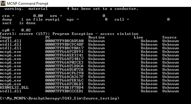

Hello all,
Starting yesterday I have been intermittently getting a " forrtl: severe <157> : program exception -access violation" and my runs stopping . Does anyone have any ideas as to what could be causing this ?
I have attached a screen shot of the entire error message
thanks

Based on the output you included as a screen shot, the last line of output was this:
Code:
cp0 = 0.02
So the exception comes after this point in the code.
Is this code you wrote, and hence have access to the source, or is it just some program you are running? I asked this back in post #4, but you didn't respond to that question.
If this is your code, it looks like some debugging is in order.

The screen shot you uploaded in post #1 has this information:
Code:
warning. material      4 has been set to a conductor.
ctm =  0.00  nrn = 0
dump   1 on file runtpi   nps = 0        coll = 0
xact   is done
cp0 = 0.02
forrtl: severe (157): Program Exception - access violation
This information is followed by a list of DLLS, that might be a stack trace.
The last line above before the exception gives a value for cp0, but the first line, which mentions material 4, whatever that is, could be the start of the problem.
Again, show us the code you wrote, and maybe we can figure out where things are going wrong.

I searched through the file by eye and with EmEditor, but did not find a cp0=0.02. What I did find was that at the start of a run with a simple code, that I know works, one of the cp0= 0.01 was printed underneath ctm etc. So I don't think the 0.02 was the issue.
I have attached the code if you have time to look over it.
Caveat: I've never used MCNP. Everything I know about it has come from looking at some documentation about the input files.
The first warning on your screen shot in post #1 refers to material 4, so I looked at the input file you posted, in the material card section.
In your input file, in the materials card, you have same materials listed in M3 and M4, which looks to me like it's a mistake. M3 and M4 both list manganese, silicon, chromium, nickel, and iron.
There's what I believe is a comment (a line starting with C) that lists oxygen and hydrogen, with what appear to be incorrect fractional amounts of about 89% and about 11%. If this is supposed to be water, the fractions should be -0.333 and -0.667 for oxygen and hydrogen, respectively.
Should what you have as m4 really be what you have in the commented line referring to M3?

Okay so the reinstall did not fix it. I checked the memory and cpu usage and I have more than enough memory and the run is using 17% of the cpu.
I also wanted to add that initial plot (ip) works and a window opens that shows problem and tally geometry.

The issue I am having is that I am once again getting the forrl:<severe> program exception error.
Can you post the input file you got the error from? Can you also post the exact command line you used to run it? Copy-paste is good.
Did you get any output file at all?
the input file is attached. The command line is "mcnp6 in= FMESH_RDF.txt
I get an incomplete output file and no meshtal file.
Here is the input file.
Update: My code has been run on MCNP 6.2 by other MCNP users and it ran, but will sstill not run on my version which is 6.1.
