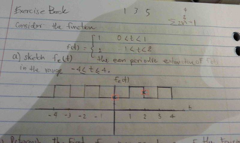

what values does the Fourier series for f(t) converge to if t = 0 and t = 2?
My answers the red rectangles for the even function t=0 >> 1 and t=2 -->1.5

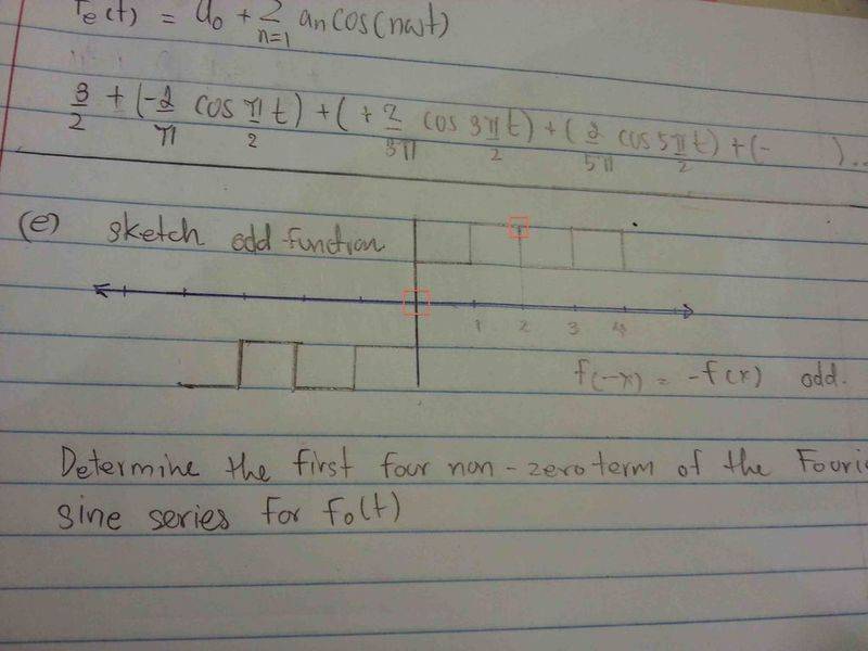

and odd function t=0 >> 0 and t=2 -->1.5
because at t=0 is continuity so the value is = f(t) but at t=2 is discontinuity so the value is average of the 2 functions.
but my answers is wrong the even function t=0 >> 1 and t=2 -->2
and odd function t=0 >> 0 and t=2 -->2
why is that ? please give some feedback thanks

For part a), you have correctly sketched an "even" function. :approve: But it's not periodic. :frown: Notice that around t = 0 there are two adjacent segments where fe(t) = 1; this doesn't occur anywhere else in the waveform, meaning the way you have sketched it, the function is aperiodic. The Fourier series only applies to periodic functions. So if this question is about Fourier series, you'll have to rethink it. (Hint: try making the first rise up to fe(t) = 2 happen at t = +/- 1/2.)
For part e), you have correctly sketched an "odd" function. :approve: But it's not periodic. :frown: Here is where the question is really weird though; you won't be able make a truly odd function such that the Fourier series applies. So the question is a little weird (maybe misleading?) in this way. I'm guessing the question wants you take the waveform from part a) and just shift it to the right or left by 1/2. It's not truly an "odd" function that way, but if the Fourier series is to apply, it must be periodic.

There's been a lot of discussion here. But I'll just get to the point. Izen, you *need* to make the function periodic. The Fourier series simply doesn't apply if the function is aperiodic. Also, the problem statement specifically says to plot the *periodic* extensions.
So let's start with the even, periodic extension. You already know what fe(t) is from 0 < t < 2. Take the mirror image of this (reflected at the y-axis), and plop it down between -2 < t < 0. Now you have an *even* function between -2 < t < 2. Now copy the whole thing between -2 < t < 2 and paste the copy between -6 < t < -2, and another copy between 2 < t < 6. (Keep adding more copies if you want to extend the periodic function out beyond +/- 6.)
Now the odd function. You already know what fo(t) is from 0 < t < 2. You've also graphed it correctly in your attached photo between -2 < t < 2. (That's one period of the function.) But your graph needs modifications elsewhere. Take exactly what you have between -2 < t < 2, and paste it at -6 < t < -2 and also at 2 < t < 6. If you do it correctly, you should end up with an *odd*, periodic function.

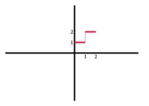

Let's start with the original function:
(I put in a vertical line at t = 1, but you can ignore that without any loss of generality. I'm just "connecting the dots" is all.)
I think we can all agree on that so far.

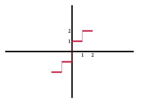

Now we have to make an *odd* function out of this. The OP did it correctly between -2 < t < 2. So I'll just copy that over:
(Again, ignore the vertical, connecting lines, if you wish.)
So far so good.
But here is the important point that I intended on making all along (although I might have done a poor job at it): The rest of function must be periodic. We have one period above, and we must extend that same period all the way from negative infinity to infinity. It must be periodic all the way though. (If it isn't periodic, the Fourier series doesn't apply.)
And we then have this:
This is the only way to make a periodic, odd function and still maintain the function's definition at 0 < t < 2.

I just found out that my both of my sketches was wrong. It should be the as collinsmark sketch.
Thank you you guys for the comments.
