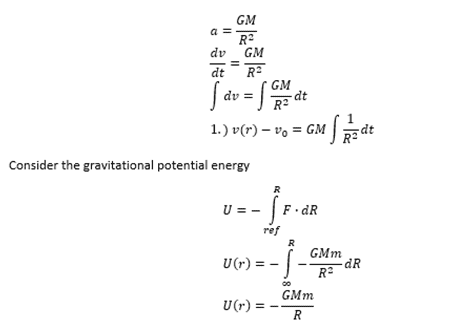

I'm trying to calculate the distance of free fall for an object with zero tangential velocity but a given radial velocity at a given height over a given period of time. This calculation cannot assume that g is constant as it deals with orbital heights. These calculations are needed for an orbital ring that I'm designing. Here is my working out so far.
1.) F=ma
2.) F=GMm/R^2
Sub 1.) into 2.)
ma=GMm/R^2
a=GM/R^2
v=da/dt
v=d/dt(GM/R^2)
v=GM d/dt(1/R^2)
R=dv/dt
R=GM d^2/dt^2(1/R^2)
I can't figure out how to solve this second order differential equation. Is there a better way of doing it/where did I go wrong?

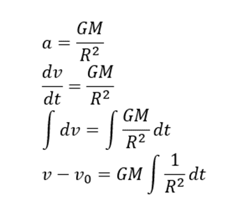

## a=\frac{dv}{dt} ##. Also ## v=\frac{dR}{dt} ##. From these two equations, you should be able to solve for an expression for the acceleration ## a ##.

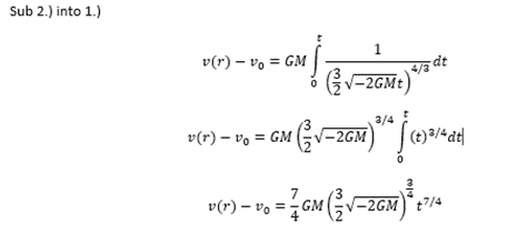

Thank you. So I tried again and got stuck again.
I don't know how R varies in time so I can't solve the integral.

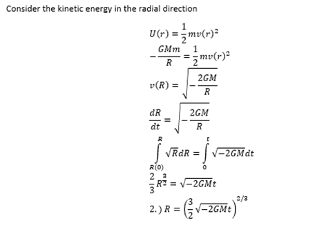

Thanks I tried to put the energy considerations in but I think I went wrong again. The final solution looks too ugly. Where did I go wrong?
Sorry the image was too small here it is again.
At ## t=0 ##, you need to use ## R=R_o ##. Also the minus sign for ## v ## goes outside of the square root. In the homework section, the Homework Helpers are not allowed to supply complete answers, but this is slightly different from a homework problem in that it doesn't seem to have a final goal. Anyway, the expression you get upon integrating is ## R(t)=(-(\frac{3}{2})( \sqrt{2GM}) t+R_o^{3/2})^{2/3} ##. Even though the velocity ## v \rightarrow -\infty ## as ## R \rightarrow 0 ##, you can still solve for the time ## t ## it will take to reach ## R=0 ## from the position ## R_o ##. Suggestion: Try setting ## R(t)=0 ## and see what you get.
