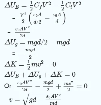

I hope both my methods are right. however, in the solution presented right below the problem, work done by the battery is not accounted for at all. Who is wrong here and why?(see below)
Handwritten-style typeset derivation of energy conservation for a falling capacitor: electrostatic energy change, gravitational energy change, kinetic energy, leading to v = sqrt(gd - ε0AV²/(md)).

To see that their answer can't be correct, suppose the experiment is done in zero gravity.
how is that possible? even their solution has included the effect of gravity right
Yes, they correctly accounted for gravity. But, they did not account for the change in chemical energy ##U_{chem}## of the battery. Their solution predicts an imaginary value for the final speed of the plate for the case where ##g = 0.##
This is a good problem for demonstrating the importance of clearly defining your "system".
If we take the capacitor, the earth, and the battery as the system, then we have an isolated system. So, ##\Delta E_{sys} = 0##. Then $$\Delta U_{cap} + \Delta U_{grav} + \Delta U_{chem} + \Delta K = 0.$$
If we consider the capacitor and the earth as the system, then the battery acts as an external agent doing work on the system. Then, $$W_{bat} = \Delta U_{cap} + \Delta U_{grav} + \Delta K.$$
