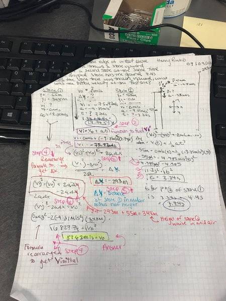

A man stands on the edge of a roof 55m above the ground, he throws a stone upward and drops a second stone at the same time. If the dropped stone hits the ground 4.4s before the stone that was thrown upward, what was the initial velocity of the first one?
1.) Δy = v02t + ½(a)t2
2.) vi = v0 + at
3.) (vi)2 = (v0)2 +2a(Δy)
I just wanted to check if my work is correct. First thing I did was realize that the first stone has two different time frame, first time frame being the point at which it is released from the mans hand which has the initial velocity I need, and the 2nd time frame in which the stone is in mid air about to be in free-fall so it would have a velocity of 0m/s. Most of the information is known about the 2nd stone. I made a quick list of variables known.
stone 1 pt 1 (thrown up-point at which it's about to be in free-fall)
y0 = 55m
yi = ?
a = -9.81m/s2
vi = 0m/s
v0 = ?
stone 1 pt 2 (free-fall-hits the ground)
y0 = ?
yi = -55m
v0 = 0m/s
a = -9.81m/s
t = ? (+4.4s)
stone 2
y0 = 55m
yi = 0m
v0 = 0m/s
a = -9.81m/s2
t = ?
I realized that the thing that connected pt 2 of stone 1 and stone 2 is the time it took to hit the ground so I used equation 1 to find t and it gave me 3.34s
I added that 3.34s to 4.4s to get 7.74s since it took 4.4s longer for the 2nd stone to hit the ground. Using 7.74s, I used equation 2 to find the height of which stone 1 at pt 2 was and I got 238m (I used equation 1 to check my answer and got the same thing). Now that I had the height of pt 2 to stone one, I plugged it in equation 3 and got v0 ≈ 60 m/s for the initial velocity of pt 1. I checked my work and plugged that number into the same equation to find vi or the velocity at which the stone is about to go into free-fall and I got 0 m/s. I just wanted to confirm if my answers and steps were correct, thanks!
A couple things look incorrect beginning with:
HRubss said:
1.) Δy = v02 + ½(a)t2
And this looks like stone1 is ending up underground.
y0 = ?
yi = -55m
v0 = 0m/s
a = -9.81m/s
t = ? (+4.4s
Whoops, forgot to put in t after initial velocity, I included it in my calculations
I just realized that if the stone was thrown upward, it wouldn't travel 55m down because the roof itself is 55m above the ground. How would I go about finding the correct position?
EDIT:
Instead of making y0 = 0m and yi = 55m (from mid-air free-fall to ground in the pt2 of stone 1, a mistake of mine) I just found Δy during stone 1's free fall and that gave me 293m meaning that the difference in height between the stone 1 at the roof to pt2 of it in free-fall is 293m(Δy)+55m(height of the roof) = 348m?

I apologize, I will try to upload a photo of my work with the steps when I get the chance sometime soon.
step numbers are shown by pink pen, my work is all over the place lol... please let me know if it's too messy to understand and I'll rewrite everything more organized!
No, No, No: don't do that! Type it out (as per the PF standards).

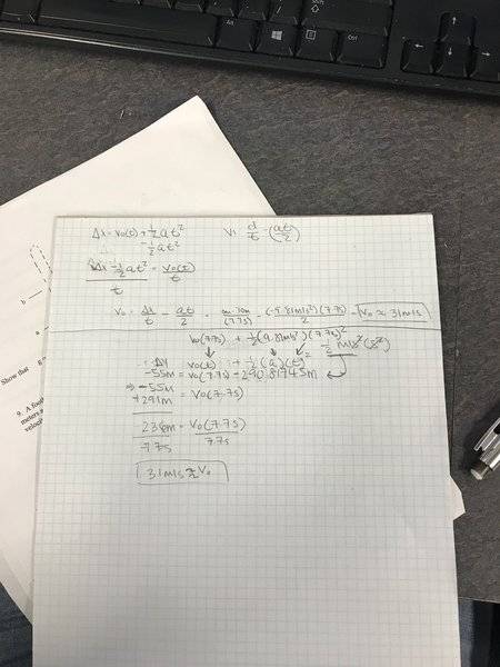

Okay, so he's what I did starting from the beginning..
I used 2 reference points for stone 1, one at the moment the stone is throwing upward with an initial velocity I need to find and the second one being at the point the stone reaches it's highest maximum height and falls to the ground. Stone 2 was pretty straight forward..
stone 2 variables:
-y0 = 55m (height of roof)
-y1 = 0m (hitting the ground)
-v0 = 0 m/s
-a = -9.81m/s2
t = ?
I assumed it's important for me to find t because it's really the only thing that links these 3 pieces of information together.
I found t by using (y1 - y0) = v0(t) + ½(a)(t)2
now inserting the numbers into the variables... (0m-55m) = (0m/s)t+½(-9.81m/s2)(t)2
Doing the basic arithmetic, I got t = 3.34s which means it took the 2nd stone that long to hit the ground from start to finish. What I'm realizing now that I goofed up is that I added the 3.34s to the stone 1's time at the point in which it's in free-fall (since it states that stone 2 hit the ground 4.4s BEFORE stone 1) I didn't realize that 3.3s + 4.4s = 7.7s is actually the full time it took stone 1 to hit the ground from start to finish, instead of the stone being in mid air. Now that I have a vital piece of information, the time it took for stone 1 to fall to the ground, I can use it to find the initial velocity.
Stone 1 variables:
-y0 = 55m
-y1 = 0m
-v0 = ?
-v1 = I don't think I need it since I'm going to be using (y1 - y0) = v0(t) + ½(a)(t)2 and that doesn't require v1.. right?
I set up (y1 - y0) = v0(t) + ½(a)(t)2 and rearrange it to get me v0 instead.
The function now looks like (2(y1 - y0) - a(t)2)/t = v0..
with the t in the bottom, I got 2 fractions, (2Δy)/t - (at2)/t but since t is squared, it cancels out with the bottom t.
After plugging in the numbers and doing the math, I got v0 = 61.25m/s. If this is right, I don't think it was necessary for me to create two different time frames for stone 1.
Check your math on this step.

Looking it up online, the proper equation should have been v0 = (Δy/t) - (at/2). Looks like instead of multiplying the constant of 2 like I did, they just inversely subtracted the +½(-9.81m/s2)(t2). For future experiences, I should just inversely bring over variables that have a constant in front of them like that instead of split them up? Well, after applying my numbers to the correct formula, I got v0 = 34m/s.
Why would yo do that when you have a perfectly good equation: (y1 - y0) = v0t + ½(a)(t)2? In a real-life testing situation, you will not have that luxury. Anyway, check your math again, 34 m/s is not correct.
Whoops, used -30m instead of -55m. It's not that I wanted to look up my answers, I just didn't trust my arithmetic and I wanted to see how the proper formula was achieved. The correct answer should be 30.6m/s or 31 m/s.
That looks right.
