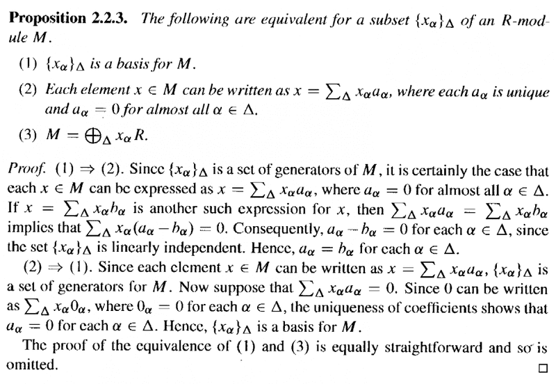

I am reading Paul E. Bland's book "Rings and Their Modules ...
Currently I am focused on Section 2.2 Free Modules ... ...
I need some help in order to fully understand the proof of the equivalence of (1) and (3) in Proposition 2.2.3 ...
Proposition 2.2.3 and its proof reads as follows:
Printed textbook page showing Proposition 2.2.3 on equivalent conditions for a basis of an R-module, with a proof of the equivalence of conditions (1) and (2).
Bland omits the proof of the equivalence of (1) and (3) ...
Can someone please help me to get started on a rigorous proof of the equivalence of (1) and (3) ... especially covering the case where [itex]\Delta[/itex] is an unaccountably infinite set ...

I'm not familiar with Bland's book, so the notation seems somewhat unusual to me.
What does he mean by 'almost all ##\alpha\in\Delta##'? Does he mean 'all but a finite number', or is there some measure in operation here (which would be surprising in a book in modules)?
What is ##\Delta##? Is it an index set for the putative basis? It seems likely to be so from the way he uses it, but it's best to be sure.
What does he mean by ##\bigoplus_\Delta##? It seems he probably means a direct sum but if so, we need his exact definition of direct sum to attempt proving ##1\Leftrightarrow 3## since there are many slightly different (but generally provably equivalent) definitions of direct sum available.

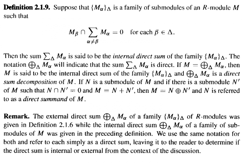

Important text from Bland regarding direct sum notation is as follows:
Printed textbook page titled Internal Direct Sums, covering submodules M1, M2, M3 of R-module M = N1 x N2 x N3 and the definition of the internal direct sum M = M1 ⊕ M2 ⊕ M3.
Printed textbook page with Definition 2.1.9 on internal direct sums: a family of submodules M_alpha of an R-module M with M_beta intersect the sum over alpha not equal beta of M_alpha equal to 0 for each beta, defining the internal direct sum and direct summands, followed by a Remark on notation for external and internal direct sums.

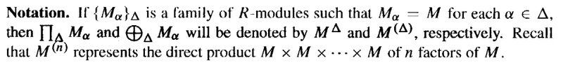

Printed text titled Notation: if {M_α} is a family of R-modules with M_α = M for each α in Δ, then the product of M_α and the direct sum of M_α are written M^Δ and M^(Δ); recall M^(n) is the direct product M × M × ... × M of n factors.

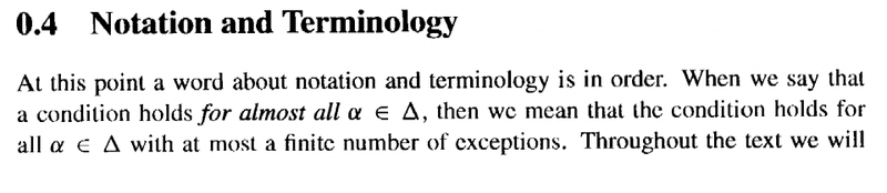

Printed page excerpt under the heading 0.4 Notation and Terminology, explaining that a condition holds for almost all α in Δ when it holds for all α in Δ with at most a finite number of exceptions.

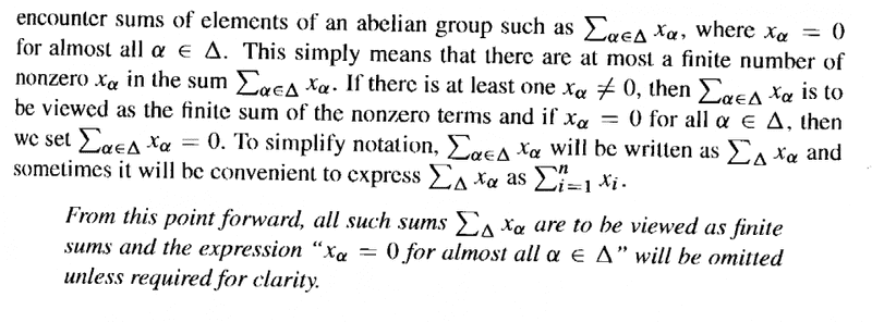

Printed textbook page with mathematical text on sums over an abelian group, defining finite sums of nonzero terms x_α and the notation Σ_Δ x_α and Σ_{i=1}^n x_i, with an italic note that all such sums are finite.
  • Printed textbook page titled Internal Direct Sums, giving an example with submodules M1, M2, M3 of M = N1 x N2 x N3, with intersection conditions and the definition of internal direct sum M = M1 ⊕ M2 ⊕ M3.
  • Textbook page showing Definition 2.1.9 of the internal direct sum of a family of submodules of an R-module M, with the condition M_β ∩ sum over α≠β of M_α = 0 for each β in Δ, followed by a remark on the direct sum notation.

  • Printed text titled Notation defining M^Delta as the direct product and M^(Delta) as the direct sum of a family of R-modules, where M_alpha = M for each alpha in Delta, and noting M^(n) means M x M x ... x M of n factors.
  • Printed page excerpt under the heading 0.4 Notation and Terminology, explaining that a condition holds for almost all alpha in Delta when it holds for all alpha in Delta with at most a finite number of exceptions.
  • Scanned printed page of text explaining finite sums over an abelian group, where only finitely many terms are nonzero, with the sum written as a finite sum from i = 1 to n and an italic note that all such sums are finite.

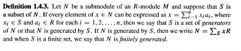

The following definition spells out notation that is relevant ... ...
Definition 1.4.3 from a textbook: N is a submodule of R-module M, S a subset of N; if every x in N is a finite sum x = sum x_i a_i with x_i in S and a_i in R, S is a generating set and N is generated by S, written N = sum over S of xR, and N is finitely generated when S is finite.
  • Printed definition 1.4.3 defining a generating set S of a submodule N of an R-module M: N is generated by S if every x in N equals a finite sum of x_i a_i with x_i in S and a_i in R; N is finitely generated when S is finite.
Printed text of Definition 1.4.3: a set S of generators of a submodule N of an R-module M, where each x in N is a finite sum of x_i a_i with x_i in S and a_i in R, and N is finitely generated when S is finite.
