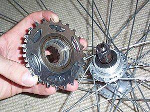

Combining multiple sources with discrete gear sets won't allow the passengers to stop pedaling while other passengers are still cycling.
Of course it will. Just use the usual freewheeling style hub...

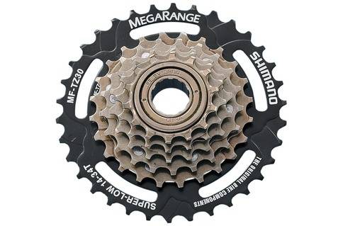

So, if I use one like the picture below, and say I apply 3 different torques to 3 different gears on this freewheel, the output torque of the shaft should be the addition of these 3 torques right?
shimano-tourney-tz30-megarange-6-speed-multiple-freewheel-14-34-tooth-EV175170-9999-1.jpg
I am still unsure how this will allow one of the 'engaged'/used gears to stop rotating while the other are still rotating.
No, you need one gearset and freewheel per pair of pedals.

That's what I was thinking originally, but I was concerned that if the passengers do not cycle at the same rotational velocity then the slower ones would not be doing any work.
I'm assuming you are using a standard tandem setup for the drive chain. That is, rider #1 has a single chain ring, rider #2 has two chain rings ("input" from rider #1 and "output"). You could observe the rider's pedaling rates and alter the size of the chain rings. For example, if rider #1 pedals 10% faster than rider #2 you could size rider #2's chain rings 10% larger than rider #1's chain ring. Same drive chain passing speed, different rotation rates. That's the simplest solution, but it does mean that all riders have to pedal at the same time (if not the same rate), and changing riders will change the gearing relation. To achieve independence between the riders you will need a freewheel clutch in the chain ring hubs.
