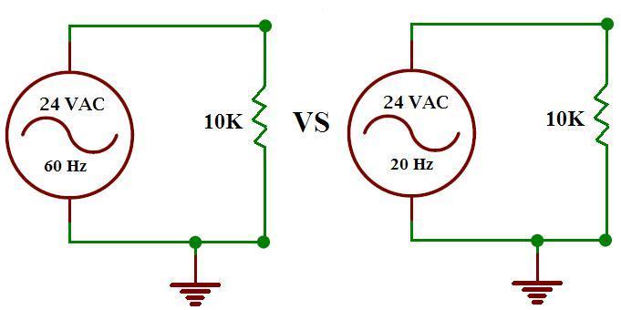

To Clarify My Question, I made an image to show it:
What will be the effect of each sources to the 10K resistor? is there any siginificant difference when the frequency was change?
Assuming 24VAC RMS sinewave. Also, assuming no parasitic capacitance or inductance (which is impossible in the real world)
In both cases the circuit will conduct 2.4ma AC and the resistors will dissipate 57.6mW.
You could theoretically have a resistive element with a fast enough thermal time constant that could be detected by a temperature sensor of some sort. Other than that, there is no difference.
You could draw in parasitic elements such as capacitance and inductance, radiation resistance, etc. Those elements would be affected by frequency.
So in this example, you are favoring for source with 60 Hz rather than the source with 20 Hz?
I have no idea what you mean. I'm not "favoring for" anything. In what way do you conclude I am "favoring". I don't think I said or implied anything judgmental about either source. I'm not even sure what your overall point is in this thread. Am I missing something?
The only real difference I see is that the 60Hz circuit is on the left.
When I said "In both cases the circuit will conduct 2.4ma AC and the resistors will dissipate 57.6mW." I probably should have added that the 60Hz source produces 60 Hz current and vice versa, but I thought that was too obvious to have to even mention.
What are you getting at?
