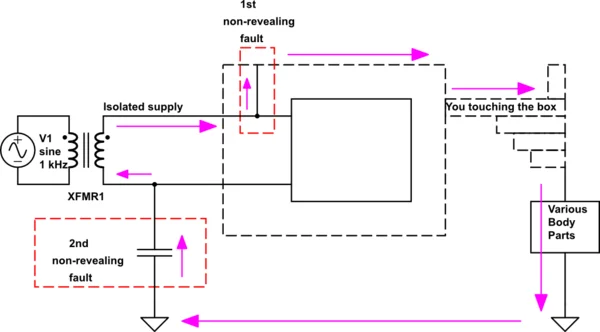

@gen x the link you proved in post #12 makes sense. The user named transistor is basically correct although I will say that a fault the the actual soil is often not enough to trip a breaker or blow a fuse. It was implied in transistor's post that this would occur. However transistor did imply that resistance of the actual earth is high enough to not make a good conductor so I will just leave it at that.
gen x said:
Why his isolated system can't use RCD to fix the fault?
An RCD can't ever fix a fault. It is designed to disconnect power to the circuit where the fault exists. Do you know how this occurs? Do you know how an RCD determines there is a problem? An RCD consists of a current transformer with both the hot and neutral passing through it. If the current on the hot and neutral is the same then there is no signal coming out of the current transformer. In a grounded system if someone is getting a shock then the current will not be the same on the hot and neutral. Some current is passing through the body of the person getting shocked and not going back to the source on the neutral. This imbalance of current through the current transformer causes an output from the current transformer and triggers a disconnect.
Here's a Wikipedia article:
https://en.wikipedia.org/wiki/Residual-current_device
Now consider the floating system with an RCD. If a person touches C or it becomes grounded in some way in the stack exchange post then no harm, no foul. It's isolated. Sounds safer right? Assume you are the one touching it. Now at the same time on the same circuit on the opposite side of the house I touch D. Now both you and I are in series across the line. The currents in each wire would be identical and there would be no reason for it to trip while you and I continue to get shocked.
Can you expalin "If we get an earth fault at D (not simultaneous with C above) then we have the same situation with LINE1 becoming N and LINE2 becoming live" ?

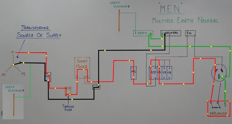

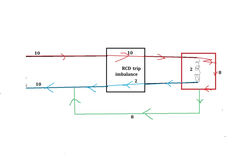

Of course I realize that an RCD works by sensing unequal currents in the live and neutral. Those currents will NEVER be unequal if the system is completely floating. The system has to be referenced to something else (the earth) upstream of the current transformer of the RCD in order for the system to allow an RCD to work correctly.
This is groudned system during fault, hot wire touch metal case, RCD trip:
This is isolated system during fault, same system without earth electrodes 1 and 2 in soil.
Most of current will travel via PE wire to neutral and back to source, so RCD will feel current imblance and trip as well.
Why you think it will not work ?
Both diagrams in post #15 will cause the RCD to trip as they are drawn. But the way they are drawn do not guarantee a floating system. The chassis of the appliance is wired to the neutral. There is no way to guarantee the chassis of every appliance is not in contact with the actual earth. These drawings are not the true floating systems represented by the drawings you link to in post #12. You are arguing about your position of an ungrounded system and then provide drawings that are obviously not ungrounded. You are contradicting yourself.

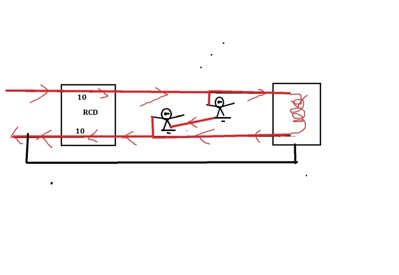

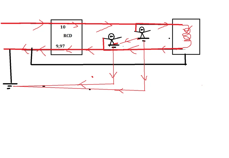

I show at diagram below, without earth electordes 1 and 2 works without any current travel through the earth, so I come to my first question what is the main purpose of connected system to earth(soil)? Lightning?
Why RCD need earth to trip or why RCD in isolated system would not trip?
I only need one parellel wire(green) to trip, not soil. Isn't it?
Why RCD will not trip in system below?

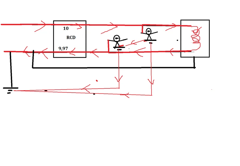

@gen x . Concerning your last diagram in post #17. Assume the chassis of your appliance is isolated from the actual earth. You've drawn with a fault from the red to the chassis. Remove that. Now have one person touch the red wire and a second person touch the blue wire. Both touch between the boxes drawn. They are standing on the earth without shoes. Do you understand how they will receive a shock and why the RCD will not trip?
Yes now part of current will travel through one person through earth to other person. RCD will not trip. Breaker will not cut power, because current is too low/earth has too big resistance, but current is enough to kill a person.
If I now connect neutral to earth, then RCD will trip at 30mA, because part of the current bypasses RCD via earth.
Is correct?
Is correct?
Yes. You have the correct idea. In the USA we refer to the RCD as a a GFCI. A receptacle that contains GFCI protection is protected at 5 mA. Any device whether it's a circuit breaker or receptacle that's designed to prevent a shock through GFCI action is supposed to have a threshold of 5 mA. Receptacles have both line and load terminals. This way whatever is connected to the load side is protected as well.

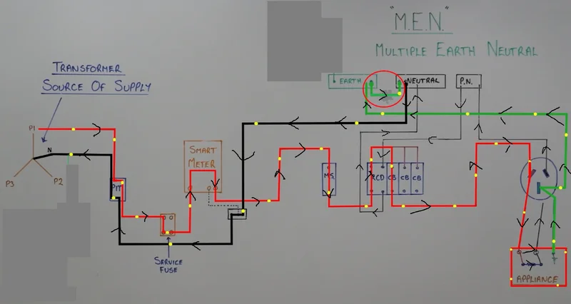

Why my diagram from post #15 without earth electrodes 1 and 2 is not isolated system?
You cannot guarantee that the chassis of an appliance will forever remain isolated from the earth. A washing machine is connected to piping and eventually that piping is connected to the earth. Even with plastic pipe in your home, eventually the water that those pipes carry will contact the earth.
But you can't guarantee at any isolated system that will remain isolated to the earth, here connection to the earth we treat as fault? So this is fault case?
