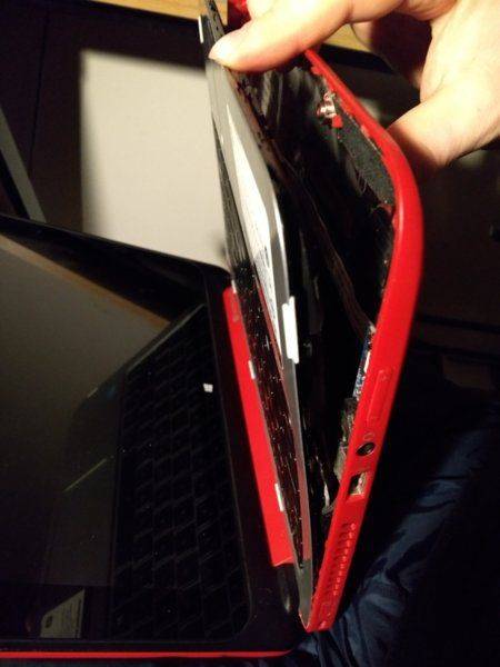

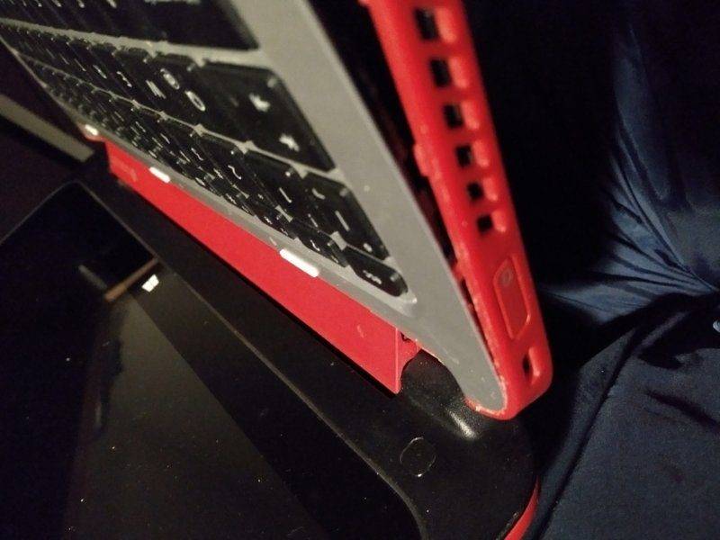

I'd like to share my bit of frustration with a HP laptop. It has a slow 5400 rpm hard disk coupled with a Celeron N2830. While it does any job I ever asked it, the experience of using it was tinted due to its slowness of responsiveness. Booting takes more than 2 minutes, opening Firefox many seconds and browsing the web is sluggish.
This is why I wanted to buy a cheap Kingston SSD to replace the hard disk, which is the main bottleneck (even more so than the processor!). But before spending 40 euros on the SSD, I wanted to be sure the hard disk had a 2.5 inches form factor, because the documentation for that laptop model is non existent (yeah, a true HP laptop, made in Brazil, without official doc).
So I tried to open it, and after about 2 hours I gave up. It's as if the electronic board was soldered to the plastic cover. I followed several youtube videos, including one of a very similar model, but my laptop was different and would definitely not behave as anything I've seen on youtube.
So, its lifetime will be the one of the hard disk I suppose. When it fails, I'll retry to open it but I may end up splitting it in half by using excessive force.
Enjoy.

A very rough guess is that there is some type of fastener under the red bar directly under the display. If you can pop that off you may be able to fully open the laptop.

I think you might be on the right track rbelli1, because I could spot a sort of metallic arm on the side I could barely open, but I do not know how to move it, and I couldn't spot any other near the totally stuck part, but then again I had a very limited view. Maybe neodymium magnets would be helpful to move those mechanical arms, but I don't have such materials. Plus I've never read about a laptop that would require such special treatment to be opened.

Hi Fluidistic,
I've been an IT guy for 30 years and besides tablets and systems that are glued together, all laptops can be disassembled. The usual design usually had a little door on the bottom that allowed for easy hard drive and memory replacement. These days, the common trend is to put everything inside the case with no easy access, forcing you to remove the bottom of the laptop as one piece.
If you are doing this for the first time, the process can be nerve racking. Usually, hard drives and memory are removed from the underside of the unit. From your pictures, it looks like you are trying to get in from the keyboard side. Take another round of looks on YouTube for your model and search for 'disassembly' or 'hard drive replacement' or 'adding memory'.
While taking apart a new model for the first time, I get a blank piece of paper and draw on the paper where the screw holes are. Or, if the paper is big enough, you can use a pen and poke holes in the paper while it is on top of the laptop. The reason I do this is many manufacturers use different length screws. If you replace a screw with a long one that should be a short one, chances are you could do irreversible damage to your computer. Some laptops use captive screws (Lenovo T-series), so you can't mix them up or lose them.
Once the bottom panel is removed, you will see what kind of hard drive is installed. More than likely it will be a standard 2.5" laptop hard drive. Most SSDs will fit. Make sure that you move any mounting brackets or shock resistant rubber parts to the replacement drive. SSDs don't need the shock resistant rubber mounts, but they help in keeping the replacement drive in place. Do check the physical size of the drive you are getting - there are new solid state technologies (such as PCIE)that have different connectors and sizes. Make sure you know what you are getting. I prefer the Samsung EVO line. I've replaced dozens of disk based hard drives with them. There is a tool you can use to migrate data, but chances are (since you are having performance issues), a clean operating system install will work wonders. I do this to most of my personal hardware every 2-3 years and it breathes life into what most people would relegate to a junior employee or their kids (after buying a new one). If you do re-install, make sure you to a complete backup of your data.
Good luck - if you still can't do this, see if you can find a friend that has done this before.​

Thanks a lot guys... I can't believe I missed those 2 hidden screws behind the rubber parts. I think they are the culprit that made it so difficult for me to open/have a look inside it...
I'll give it another try later tonight. And yeah this was the first time I tried to open a laptop, and I spent like 2 hours forcing here and there.
I finally could open the laptop, but the battery screws were very tightened and although my screwdriver fits, it doesn't fit perfectly so that I have to apply a lot of force. It turns out the last screw, which tightnen the battery over the hard drive, is too tightened and I started to get a stripped screw, so I gave up momentarily. I might use a rubber band to help to unscrew that screw. And yes it's a 2.5 inches form factor hard drive which I'll replace for a cheap Kingston ssd. I have already backed up the important data and I plan to do a fresh linux install.

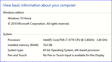

Don't even begin to talk about laptop performance without first telling us the OS version and how much RAM you have. Lack of enough RAM is probably the most common cause for slow performance in Windows these days.
4 GB of RAM, GNU/Linux (Arch Linux). The OS eats about 240 MB of RAM at start. I very rarely exceed 2 GB of RAM used. I'll never upgrade the RAM.

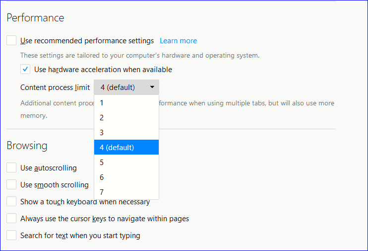

As non-intuitive as it sounds, if you have sufficient memory and a decent connection speed, a way to extend the working life of older computers is to turn browser disk-cacheing off. And a couple other things with increasing risk of losing data, just to avoid the HD bottleneck. But yes, SSD's rock, and are well worth the pittance they cost.

I've been using the laptop and the only thing still sluggish, is when I toggle or untoggle the full screen mode in youtube for high definition videos (Firefox).
Firefox, eh.... :oldwink:
There are some settings you might try fooling with.... :olduhh:
Firefox's performance settings...
My computer is a bit different than yours, though...
