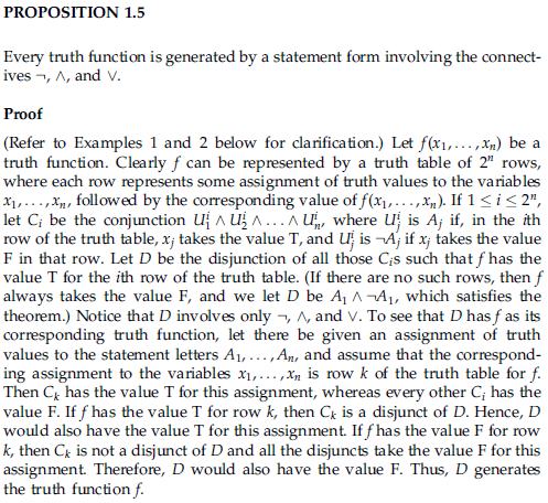

While I was studying Propositional Calculus from Elliott Mendelson's "Introduction to Mathematical Logic," I came across, on page 18, the proof of functional completeness of \neg, \wedge, \lor logical connectives as shown below:
The part that does not make sense to me starts from "Then C_{k} has . . ." down to the end of the proof.
Question: Why does C_{k} have the T value for this assignment?
Likes Periwinkle
Can you elaborate more by which "then ##C_k##" you're referring to as there are at least three that I see:
- Then ##C_k## has the value T...
- then ##C_k## is a disjunct of D.
- then ##C_k## is not a disjunct of D
By that I meant the following sentences:
"Then C_{k} has the value T for this assignment, whereas every other C_{i} has the value F. If f has the value T for row k, then C_{k} is a disjunct of D. Hence, D would also have the value T for this assignment. If f has the value F for row k, then C_{k} is not a disjunct of D and all the disjuncts take the value F for this assignment. Therefore, D would also have the value F. Thus, D generates the truth function f."
I could not grasp these following steps. For instance, why does C_{k} in the first sentence have to be T?
Maybe it would help to work out a particular example. Let ##f(x_1, x_2, x_3)## be "if ##x_1## then ##x_2## else ##x_3##". Then the truth table looks like this:
$$\left[ \begin{array}
\\ & A_1 & A_2 & A_3 & f(A_1, A_2, A_3)
\\ 1 & T & T & T & T
\\ 2 & T & T & F & T
\\ 3 & T & F & T & F
\\ 4 & T & F & F & F
\\ 5 & F & T & T & T
\\ 6 & F & T & F & F
\\ 7 & F & F & T & T
\\ 8 &F & F & F & F
\end{array}
\right]$$
There are 8 possible assignments of values to ##A_1, A_2, A_3##
So we have the following values for ##C_i##:
\\ & C_j & f
\\ 1 & A_1 \wedge A_2 \wedge A_3 & T
\\ 2 & A_1 \wedge A_2 \wedge \neg A_3 & T
\\ 3 & A_1 \wedge \neg A_2 \wedge A_3 & F
\\ 4 & A_1 \wedge \neg A_2 \wedge \neg A_3 & F
\\ 5 & \neg A_1 \wedge A_2 \wedge A_3 & T
\\ 6 & \neg A_1 \wedge A_2 \wedge \neg A_3 & F
\\ 7 & \neg A_1 \wedge \neg A_2 \wedge A_3 & T
\\ 8 & \neg A_1 \wedge \neg A_2 \wedge \neg A_3 & F
\end{array}
\right]$$
Then ##D## is the disjunction of all the ##C_i## where ##f## has value ##T##:
##D = C_1 \vee C_2 \vee C_5 \vee C_7 == (A_1 \wedge A_2 \wedge A_3) \vee (A_1 \wedge A_2 \wedge \neg A_3) \vee (\neg A_1 \wedge A_2 \wedge A_3) \vee (\neg A_1 \wedge \neg A_2 \wedge A_3)##
Now, let's augment table 1 to include the values of ##C_i## and ##D##. I'm bold-facing those ##C_k## that are in the disjunction ##D##.
\\ & A_1 & A_2 & A_3 & f(A_1, A_2, A_3) & \mathbf{C_1} & \mathbf{C_2} & C_3 & C_4 & \mathbf{C_5} & C_6 & \mathbf{C_7} & C_8 & D
\\ 1 & T & T & T & T & T & F & F & F & F & F & F & F & T
\\ 2 & T & T & F & T & F & T & F & F & F & F & F & F & T
\\ 3 & T & F & T & F & F & F & T & F & F & F & F & F & F
\\ 4 & T & F & F & F & F & F & F & T & F & F & F & F & F
\\ 5 & F & T & T & T & F & F & F & F & T & F & F & F & T
\\ 6 & F & T & F & F & F & F & F & F & F & T & F & F & F
\\ 7 & F & F & T & T & F & F & F & F & F & F & T & F & T
\\ 8 &F & F & F & F & F & F & F & F & F & F & F & T & F
\end{array}
\right]$$
So what they're saying is that ##C_k## has value ##T## for assignment number ##k##, and that ##C_k## has value ##F## for every other assignment. If ##C_k## is in the disjunction ##D##, then ##D## has value ##T## for assignment ##k##, otherwise ##D## has value ##F##. So we can see that ##D## is true exactly the same rows that ##f## is.

I noticed my misunderstanding. All is clear now. Thank you very much!
