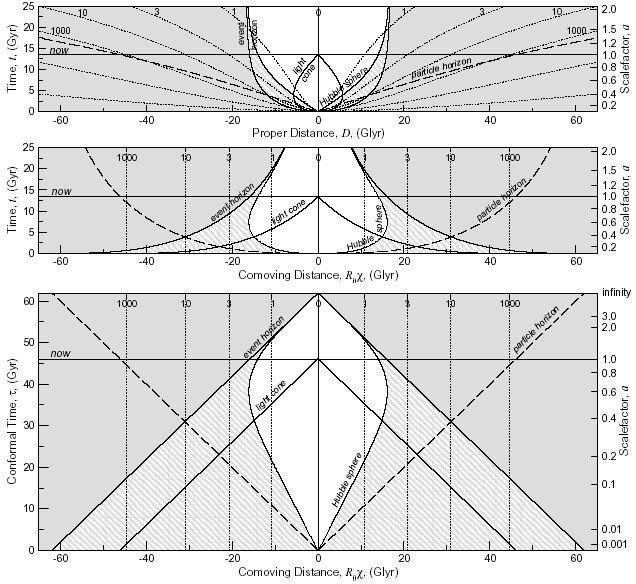

Based on standard cosmology, yes, for example in Charles Lineweaver's 2003 article "Inflation and the CMB"
==abstract==
http://arxiv.org/abs/astro-ph/0305179
Inflation and the Cosmic Microwave Background
Charles H. Lineweaver (School of Physics, University of New South Wales, Sydney, Australia)
(Submitted on 12 May 2003)
I present a pedagogical review of inflation and the cosmic microwave background. ...
34 pages, 13 figures.
==endquote==
Lineweaver's tutorial is something of a classic. It is also online at the Caltech "Level 5" website.
http://ned.ipac.caltech.edu/level5/March03/Lineweaver/Lineweaver_contents.html
It's interesting to notice that in the bottom diagram which uses a "conformal" timescale (fake time making speed of light constant in comoving distance) the particle horizon, in comoving distance, is the "mirror image" of the event horizon
