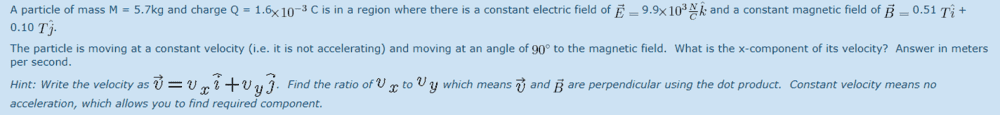

See attached
F=qE, F=qv cross product B
So I know the acceleration is 0, so the net force is 0.
QE=1.6E-3*9.9E3 k hat = 15.84 k hat (thats one force)
qv x B = q(v i hat + v j hat) x (0.51 i hat + 0.10 j hat)
=q(0.10 v k hat- 0.51 v k hat)
=q(-0.41 v k hat)
=-0.000656 v k hat
Now solving for velocity,
0.000656v=15.84, v=24146.34146
The question says I need to find the ratio, and I know vy is .41 times higher, so i multiply by this to get 9890.
This answer is wrong, it should be -3665.31.

Perhaps it would be conceptually easier for you to write two equations, one saying that the net force on the particle is zero and another saying that the velocity is perpendicular to the magnetic field. You will have two equations and two unknowns, ##v_x## and ##v_y##.
Don't forget that the net force is the sum of an electric force and a magnetic force.

Thats what I did when I tried to solve it, but I got stuck because I have two unknown variables now (the two different velocity vectors).

You made a mistake in this calculation of cross product. Maybe you can write down the determinant explicitly and try to figure out what are the components.
There is another hint in your question that you didn't use - the velocity is perpendicular to magnetic field. As mentioned above, you will have two variables and two equations.
What equation is that?
##\vec B\cdot \vec v=0.##
Wouldn't that just mean the velocity is 0 then?
No. It's another way of saying that the two vectors are perpendicular. I suggest tht you review dot products and cross products.

So then the velocity is either -1.96 i hat + 10 j hat or 1.96 i hat - 10 j hat if its perpendicular. But this doesn't really help me.
How did you arrive at these numbers? Are these the only choices that make the magnetic field and velocity perpendicular? Remember that the particle has to go in a straight line. As I mentioned before, the net force on the particle must be zero because we are told that it is moving in a straight line. See post #4.
Because with the dot product they give 1-1, which is 0. I don't see why it wouldn't be a straight line, it would go in the direction of the vectors.
Which direction is this and which vectors are you talking about? There is an electric field along the z-axis and the magnetic field in the xy plane. The particle's velocity is perpendicular to both the electric and magnetic field. Therefore it is not movinfg along either field.
Having the velocity perpendicular to the field is not enough to ensure that the particle is moving in a straight line. That's because the magnetic force on the particle is velocity-dependent. The velocity has to be just right so that the sum of the electric and magnetic forces on the particle is zero.
I know B=0.51 i hat + 0.10 j hat. I need to find the ratio of vx to vy by making the dot product =0.
(0.51 i hat + 0.10 j hat) * (1.96 i hat -10 j hat) =0. (0.51 i hat + 0.10 j hat) * (-1.96 i hat + 10 j hat) is also 0. I assume this means that the vx has a ratio of 0.196 to vy.
Sure, but that is not enough to determine vx and vy separately. It is also true that
(0.51 i hat + 0.10 j hat) * (2*1.96 i hat -2*10 j hat) = 0
(0.51 i hat + 0.10 j hat) * (23.4*1.96 i hat -23.4*10 j hat) = 0
(0.51 i hat + 0.10 j hat) * (1065*1.96 i hat -1065*10 j hat) = 0
And so on. You get the picture? Like I said, of all these infinitely many choices of velocities perpendicular to the magnetic field, only one is correct and will result in the particle following a straight line. The equation saying that the net force is zero will give that correct choice.

Write the equation ##q\vec E+q\vec v\times \vec B=0## correctly in terms of ##v_x## and ##v_y##. I gave you a link in post #7 if you don't know how to do that. That is the second equation, the first one being ##B_x v_x+B_y v_y=0.##

Using the ratio, you can express ##v_y## in terms of ##v_x## (also ##v_x## in terms of ##v_y##). Then you reduce the problem to a problem with only one unknown variable.
okay here's what I did.
Knowing B x (vx + vy)=0, I found the ratio of vx to vy was -0.196
Now I also know 0=qE+qv x B
-E=v x B
-E=(vx i hat -vx/0.196 j hat) x (0.51 i hat + 0.10 j hat)
-E=0.10vx k hat+2.602vx k hat
-E/(0.1+2.602)=vx=-3664
This is one less than the right answer so I am assuming i made some rounding error.
Thanks for the help everyone! Took me a while but I got it...

Here's my method:
##\vec E+\vec v\times\vec B=0##
##\vec v.\vec B=0##
Taking the cross product of the first equation with ##\vec B##:
##0=\vec B\times\vec E+\vec B\times(\vec v\times\vec B)=\vec B\times\vec E+(\vec B.\vec B)\vec v-(\vec B.\vec v)\vec B=\vec B\times\vec E+(\vec B.\vec B)\vec v##
Whence ##\vec v=-\frac{\vec B\times\vec E}{\vec B.\vec B}##
