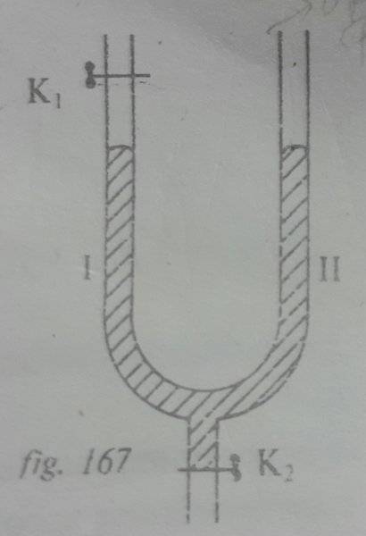

The open legs 1 and 2 of an U-shaped tube have a diameter of 2 cm^2. In leg 2, mercury is poured. When the distance is 16cm from the mercury level up to the valve K1 , then the valve gets closed. The barometer reading is 76cm Hg.
a) How big is the pressure of the sealed air?
b) Opening valve K2, then the mercury in leg 2 appears to drop faster than leg 1. Explain this.
c) When the sealed air has reached a length of 19 cm, this valve K2 is closed.
How big is the pressure of the sealed air and how much cm^3 Hg has been drained?
So I had no trouble answering question a, the answer is air pressure = sealed air.
Now comes question b. My teacher told me that the pressure in leg 1 is bigger than the pressure in leg 2, that's why the mercury in leg 2 is dropping faster, but I still fail to see how the pressure is of leg 1 is bigger than leg 2.
c) I'm kinda lost on what equation(s) I have to use to calculate the pressure and how much cm^3 Hg has been drained. It's like a few informations are missing, but then again I might be wrong and there is way out there to calculate it.
So far I've got only :
- P = F/A (P = Pressure, F = Force, A = Area)
- P1 x v1 = P2 x v2 ( P= Pressure , v = Volume)

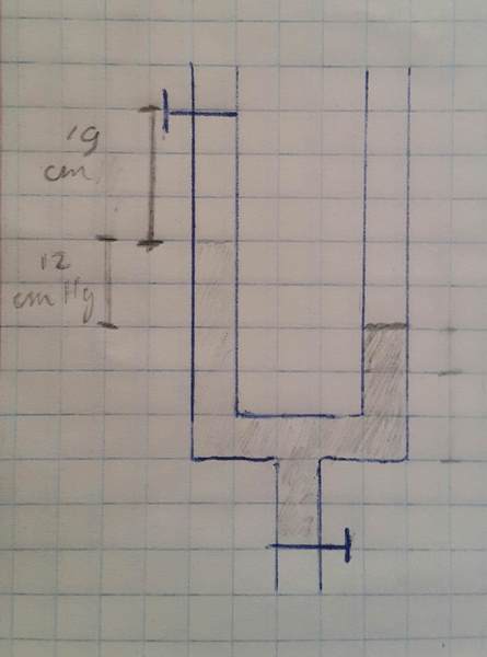

Now the pressure above the mercury in leg 2 is atmospheric. The pressure above the mercury in leg 1 is 64 cm Hg. At what distance below the mercury surface in leg 1 will the pressure be equal to atmospheric? The mercury level in leg 2 will be at this height. Can you see why?
mjc123 said:
Do you think the mercury in leg 2 hasn't moved? Why? What about your answer to part b?
Well it has moved, because the air pressure was higher than the trapped air.
12cmHg

Why do you say that? Can you draw a diagram of what you think the system looks like at this stage?
Ah, I think I've misunderstood the question "What is the difference in height of the mercury columns in legs 1 and 2?"
So I actually need to tell the difference of each of column right?
In leg 1 : 19cmHg - 16cmHg = 3 cmHg
In leg 2 : Eh, would you like to help me on this one? Since I don't really understand the following part "At what distance below the mercury surface in leg 1 will the pressure be equal to atmospheric? The mercury level in leg 2 will be at this height. Can you see why?"

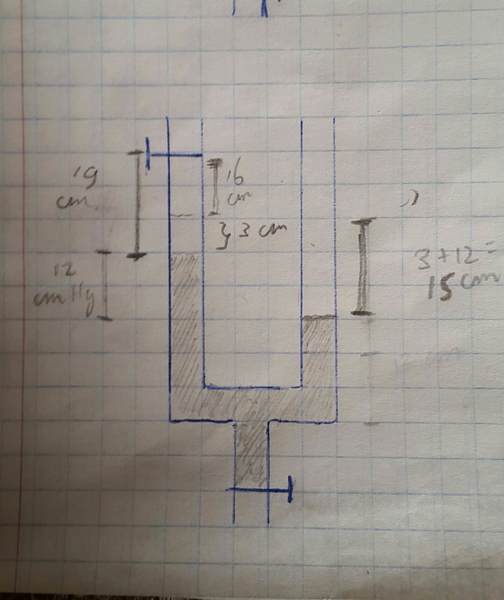

I thought I was helping you. I don't see what you don't understand. Can you do what I suggested and draw a diagram?
On edit :
Ah I see it now, so the difference of leg 2 is 15cm Hg. Total = 3cmHg(leg 1) + 15cmHg(leg 2) = 18 cmHg has drained.
Now you can get the Volume :
V = 2 × 18
V = 36 cm^3
:smile:
I agree with your answer. Do you see why they say "a picture is worth a thousand words"?
