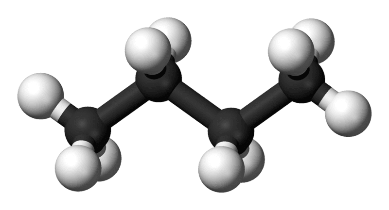

I'm a visual thinker so I struggle a bit to get my head around calculus concepts. So as an example, here's a potential energy surface:
lets say this represents the structure of a simple molecule like n-propane:
the molecule in the picture is the most stable conformation so the global minimum (the big pit) on the PES represents that conformation. Then the local minimum (the little bit) represents the staggered conformation. If I rotate or stretch the bonds in any other way, then it becomes less stable so the molecules energy will no longer be represented by a minimum on the PES.

Oh dear, Myco! The molecule you are dealing with up in the first post is n-butane, not propane, but that is a fairly minor problem!

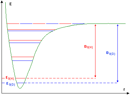

After reading you're post, I understand the concepts of curvature and why the number of second deratives there are for depends on the number of dimensions involved. What I really want to understand now is how IR vibrations come into all this. In a freq scan, I know that Gaussian calculates a negative vibrational frequency if the structure is a saddle point and numerous negative frequencies for higher order saddle points so I can see a clear correlation between the second derivative and the calculated frequencies but I'm trying to visualise how they are actually related. Let's use carbon monoxide as an example. Its a linear diatomic molecule so it has only a single stretching vibration (which is IR active if I'm not mistaken). How does Gaussian use the PES to find this vibration? If I'm not mistaken, a diatomic molecule has a 2 dimensional PES because it can only stretch and contract. I'm guessing its PES looks like an anharomic oscillator:
the minimum of this PES only has 1 second derivative. I'm starting to see how this pit corresponds to molecular vibration but how does Gaussian know where the normal modes of vibration are located in this pit?
