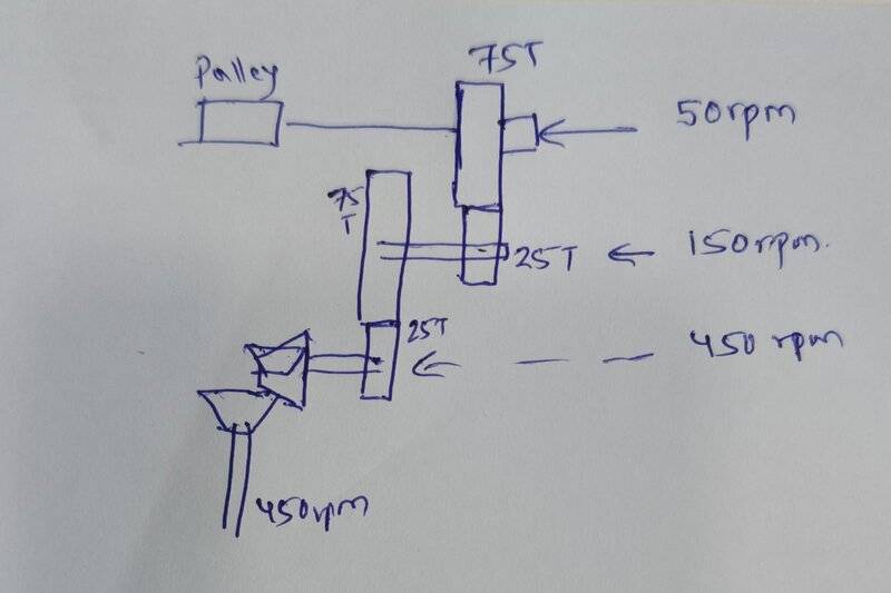

2. Now the input gearmotor is connected to the 24Teeth Spur Gear in the middle of the gearbox. Can I re-design it to have the input gearmotor mounted near the top? See image below..
The input gearmotor will be the 50RPM one at the top driving the 75 Teeth Spur gear in this layout. I am going to use PWM to vary the speed of both outputs.
Comments/Suggestions/Corrections are welcome please. Thank you!

In my illustration, the input gearmotor of 50RPM is actually connected to the top gear i.e 75T helical which drives the 25T helical gear @150RPM. Another 75T Helical is mounted on this shaft which then drives another 25T helical @450RPM. Here the Bevel gears of 1:1 ratio are proposed to take the 450RPM drive to the Impeller on the vertical shaft.
Won't a 46T bevel driving a 15T bevel reduce the torque at the 15T bevel shaft?

Yes but how will a horizontally mounted 450RPM gearmotor be able to transmit that 450 RPM vertically downwards (at right angle using bevel) AND give me 50 RPM in the same axis as the gearmotor? I thought about this but I am unable to think of a geartrain that will enable this.
For eg. I will connect a 1:1 bevel gear set to transmit the 450RPM at 90 degrees. But how will I get the 50RPM drive ?
I could connect a 1:9 spur/helical set to get the output, but I am afraid the driven gear here will be too large.

Smallest issue with this.. if I mount the motor vertically (shaft pointing downwards), this will increase the total height of my gearbox (and machine). the input motor has to be mounted horizontally :headbang:
What i meant by 'top' is actually where the topmost shaft is located. there are 3 shaft, currently in the video you can see the gearmotor in the 2nd shaft (the one in the middle). I was wondering if the gearmotor can be connected to the topmost shaft. Sorry if I was unable to make myself clear
That is an irrational constraint on the solution.
Your gearbox is quite tall, and houses much expensive complexity. If you throw out most of that complexity, the gearbox height will collapse, and there will be more than sufficient space for the motor, in the place of the old gearbox.
Why must you have so many gears? Why not just use two gear motors?
Is there some reason why the impeller must be mechanically locked to the belt speed?
I ask again. How many of these gearboxes do you intend to manufacture?
