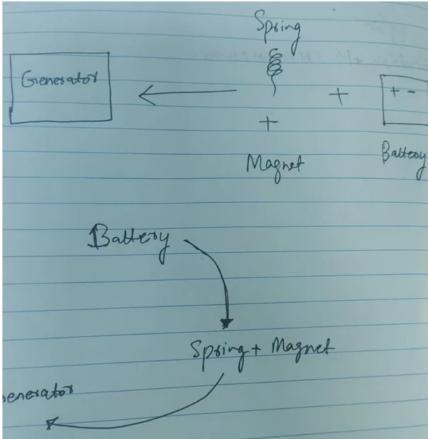

Hi Respected Teachers and Members ,
I would like to know that how can i run electrical generator through spring and magnet mechanism , The source can be battery to spring and magnet mechanism and spring and magnet mechanism run the shaft of generator and produce electricity
Thank you very much
What is the point of this device? I can't think of a good reason to power a generator with a battery except to change the voltage or to turn the DC into some sort of AC power, and those don't typically use 'springs and magnets'. You're not thinking that this could be turned into some sort of perpetual motion device, are you?

In fact, this idea would work like this: generate electricity on an electric bike when the bike is in motion, we have to generate electricity to charge the battery, so wants to use the energy from the battery and run the generator and to have enough electricity to charge the battery.
Then the spring and magnets are not helpful. You want to just have the battery and the generator. When you want to charge the battery you take mechanical energy from the person, use the generator to convert it to electric power, and store it in the battery. When you want to assist the person you would simply run the same devices in reverse. You would discharge the battery, supply electric power to the motor and convert it to mechanical energy to assist the person. A motor is just a generator run in reverse
Obviously you cannot use the battery's electricity to charge itself, so I hope that's not what you were trying to do. You cannot even use the motion of the bicycle unless you're recovering energy during braking.
how about If we connect battery to generator and have electricity so that we have less loss.
The only way you get less loss is if you use the generator for braking. This is the principle of hybrid automobiles.
