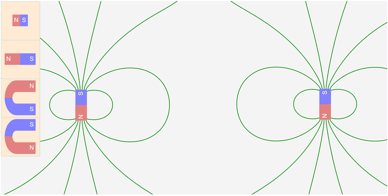

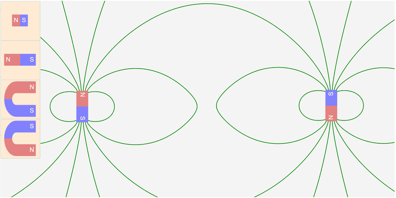

Lets start by standing the bar magnets up vertically instead of laying them horizontally in the container.
I think it will look something like this...
if the poles that pointing to each other are similar.
and this...
if the poles are dissimilar.

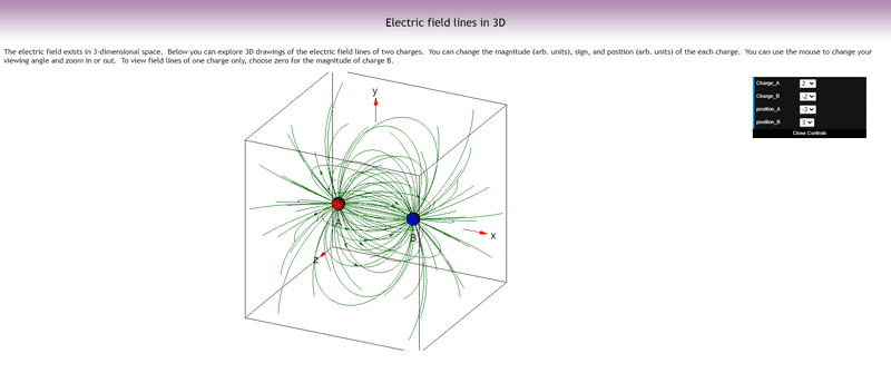

Combine these magnetic field lines with a 3D electric field lines like the image below...
will result to field lines that consisted of intersecting and non-intersecting field lines.

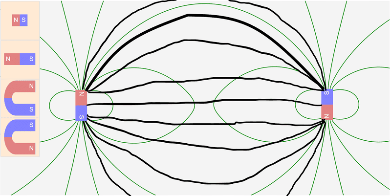

What I mean is what will the field lines (including the electric field lines that we saw earlier in the video) look like if we use two erect bar magnets as the conductors instead of the nails like in the video? Did they (both the electric field lines and magnetic field lines) look like this...
Baluncore said:
How can field lines intersect other field lines of the same field?
What different fields are you considering.
I thought the resulting field lines will look like this...
The black line is the electric field lines that is also the same electric field lines that we saw in the video. Sorry for the terrible drawing of electric field lines.
