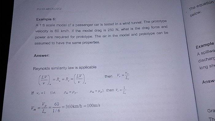

in this question , Lm / Lp = 1/ 6 ? or Lp / Lm = 1/6 ? Lp = length of prototype , Lm = Length of model
i really have no idea... can someone help please?

i am in uni now , and the notes is from my book , IMO , it should be Lp / Lm = 1/6 , am i right ?
can you help ?
i don't think the working provided is correct
IMO , it should be (Vr)( Lr )= (nu)r
nu = kinematic viscosity
since nu is constant , so ,
Vp / Vm = Lm / Lp
60 / Vm = 1/6
so , Vm = 360km/h , am i right ?
thus , force has formula of ρ(L^3)(velocity) , so force is directly proportional to v ,
Fp / Fm = Vp / Vm
Fp / 250 = 60/360 , Fp = 41.7N , is it correct ?
