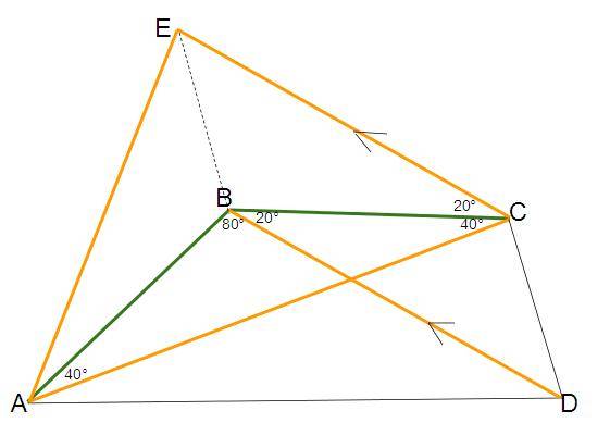

Hint:
Draw a line parallel to $BD$ from $C$ and see where that leads you...
anemone said:
Hint:
Follow up hint:
Construct an equilateral $\triangle ACE$ where $CE$ is the line parallel to $BD$.

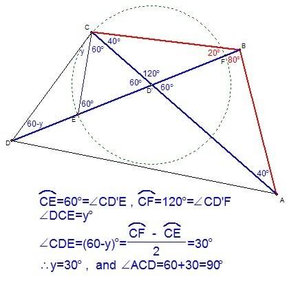

anemone said:
Let $ABCD$ be a convex quadrilateral such that $AB=BC,\,AC=BD,\,\angle CBD=20^{\circ},\,\angle ABD=80^{\circ}$. Find $\angle BCD.$
$130^o$

MarkFL said:
Please provide how you obtained your solution. :)
step 1 :construct $\triangle ABC$ ,it is fixed , for $AB=BC$ , and $\angle ABC=20^o+80^o=100^o$
$\therefore \angle A=\angle C=40^o$
step 2: find point $D'$ on $AC$, and $\angle CBD'=20^o$
(step 1 and 2 can be done easily)
now point D must be on $BD'$ ray
step 3: construct circle $B$ with center $B$ and $BD=AC$
here point $D$ is the intersection of circle $B$ and $BD'$ ray
so $\angle BCD=\angle BCA+\angle ACD=40+90=130^o$

Albert said:
$r=BD=AC$
Okay, thanks for your reply...but Albert, I have constructed the diagram and drew everything up according to suggestion, but, I failed to see why $\angle ACD=90^\circ$.
$\angle ACD=90^o$

Albert said:
$\angle ACD=90^o$
Oh okay...thanks for your diagram!
Btw, the solution below is from a smart mathematician:
Draw a line parallel to $BD$ from $C$, and then construct an equilateral $\triangle ACE$ where $CE$ is the line that parallel to $BD.$
Note that $\triangle AEB \equiv \triangle CEB$ and since $BC=CB,\,\angle BCE=\angle CBD,\,CE=AC=BD$ (given), we have $\triangle BCE \equiv \triangle CBD$.
$\therefore \angle BCD=\angle CBE=180^\circ-20^\circ-\dfrac{60^\circ}{2}=130^\circ$
