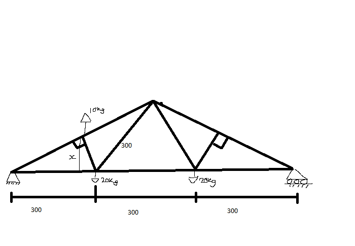

I'm to work out the internal forces in this truss. I know to get the reaction forces first, so I take the moment at the pin support to find the reaction at the roller support. I can't get my head around at how to find x through the geometry to add that force to the moment though. Is there not enough information in the diagram to find it? Or am I missing something simple?
Yes you need the 'rise' or vertical height of the truss as well as the span. Alternatively you need the pitch (angle to the horizontal) of the roof.

Look at the truss carefully. What kind of triangle is formed by the members in the center of the truss?
Look at the truss carefully...
Well spotted steamking you are spot on.
