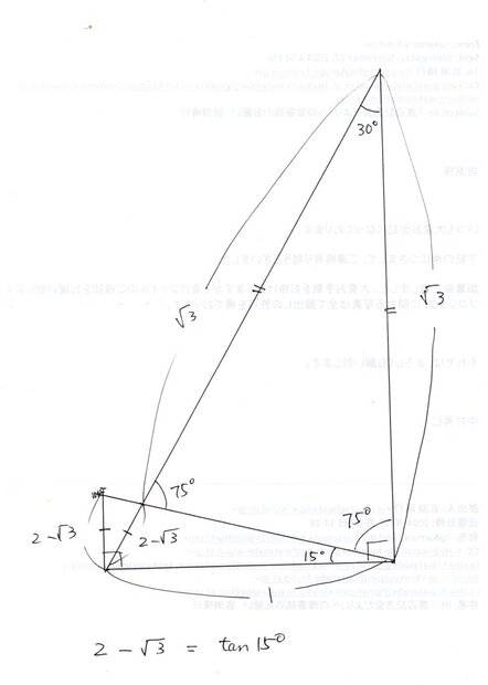

Geometry of
2-\sqrt{3}=tan \frac{\pi}{12}
