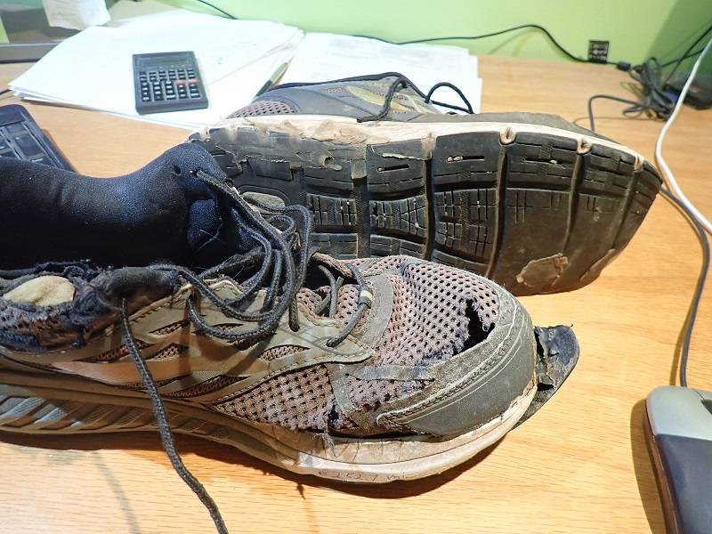

I had a good pair of running shoes where the outsoles came off. I glued the soles back on using contact cement, and got another 900 miles before one of the soles started to come off again. By that time, the uppers were shot, so I gave in and bought a new pair of shoes. Plus I went through several tubes of Shoe Goo to build up worn spots on the soles.
My previous record shoe miles was the previous pair that lasted slightly over 3000 miles. My shoes started lasting longer when I got old and slowed down.
I also read that advice in numerous sources. Other people need to replace their shoes more often.
There was a time when I had a new and old pair of summer and winter (four pairs total) of running shoes. I could not feel the difference, so ended up with one pair each of summer and winter running shoes. Even at over 6000 miles, my feet did not complain. I just got tired of looking at and fixing them.

Looking at that photo I can't help but wonder about the rest of your ensemble. :-)
