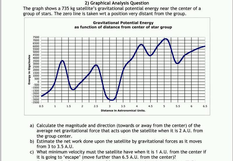

1. Problem statement and all known/given variables
Line graph titled Gravitational Potential Energy as function of distance from center of star group, energy in GigaJoules on the vertical axis from -3500 to 7500 against distance in Astronomical Units from 0.5 to 6.5, showing a curve with several peaks and troughs.
2. Related equations
W = fd
Newtons kinematic equations
3. Attempt at solution
For part a) since the magnitude of the work done by gravity to 2 a.u is 2500GJ I use the equation W = fd and I solve for f by dividing work by the distance 2500 = f(2a.u) (after I convert the units).
For part b) I just looked at the graph and saw that the change in gravitational energy was 4500GJ so I'm assuming that's what they are asking for?

For part A, I think it would be more appropriate if you were to find the slope of the graph at distance =2 A.U. Because the infinitesimal work done by gravity dW when the satellite is moved from 2 A.U. by a very small distance dx is dW = F.dx and hence F=dw/dx at that point (which is simply the slope)
Part B is all right.
Part C has a minor glitch. You see, in order to go to 6.5 A.U. the satellite must overcome a potential energy barrier of more than 7000 GJ at around 5 A.U. If the velocity cannot overcome that potential energy barrier (i.e. If you don't provide it enough kinetic energy to cross 5A.U.) the satellite will never be able to go across to 6 A.U and hence it cannot escape.

The way I interpret the graph, freshcoast, you are off by 500 GJ for part B's magnitude.
Secondly, is that value the work done on the satellite by gravitational forces, or is it the other way around? (Is the change in the satellite's position the same direction as the force, or in the opposite direction?) (Still in other words, pay attention to the sign. If gravitational forces are pushing the satellite in the same direction the satellite moves, the work done by the gravitational forces is positive. If the gravitational forces pull the satellite in the opposite direction the satellite moves, the work done by the gravitational forces is negative.)

If the force were uniform, you could say [itex]W = Fd[/itex]. But in this problem, the force is anything but uniform. But over a small enough [itex]\Delta d[/itex] you can approximate a linear portion of the curve to find [itex]\Delta W[/itex]. So even though the forces are not uniform, you can still claim that [itex]\Delta W = F \Delta d[/itex] for a small range [itex]\Delta d[/itex]. Solve for the force.
And once again, pay special attention to the direction. Are [itex]F[/itex] and [itex]\Delta D[/itex], over this particular portion of the curve, in the same direction or opposite directions?
part b the work would be in the positive direction since it went from negative work to positive work
You might want to rethink that.
The graph is plotting the satellite's gravitational potential energy. As the satellite traves from 3 to 3.5 AU, it gains potential energy.
  • What does that tell you about the satellite's kinetic energy? (Think conservation of energy.)
  • And what does the satellite's kinetic energy tell you about the satellite's speed? (Is it speeding up or slowing down?)
  • What does that tell you about the direction of force compared to the direction of motion?
