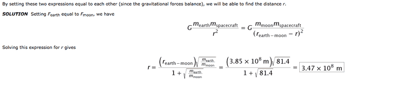

How was this formula derived? Gravitational stuff...
This is embarrassing but I need to understand it. I'm trying to understand how to solve a problem but I don't understand how one of the variables was isolated for and I was hoping someone here could explain it please. It's seemingly basic algebra. And it's either really late and I'm tired or I'm dense.
So, how the heck did r end up alone?

Exchange LHS numerator and RHS denominator. Take square root. Do you see it now?

Then take the sqrt of the whole thing?... Not yet.
Edit: I need a step by step..
Step 0: [itex]G\frac{m_{earth}m_{ spacecraft }}{r^2} = G\frac{m_{moon}m_{ spacecraft }}{(r_{earth-moon}-r)^2}[/itex]
Step 1: [itex]\frac{(r_{earth-moon}-r)^2}{r^2} = G\frac{m_{moon}m_{ spacecraft }}{Gm_{earth}m_{ spacecraft }}[/itex]
Step 2: [itex]\frac{(r_{earth-moon}-r)}{r} = \frac{\sqrt{m_{moon}m_{ spacecraft }}}{\sqrt{m_{earth}m_{ spacecraft }}}[/itex]
Step 3: [itex]\frac{r_{earth-moon}}{r} - 1 = \frac{\sqrt{m_{moon}}}{\sqrt{m_{earth}}}[/itex]
How about now?

To make r end up alone, you need to apply a series of fraction manipulations.
In this particular case, one of the steps is that:
$$\frac{r_{earth-moon} - r}{r} = \frac{r_{earth-moon}}{r} - \frac r r = \frac{r_{earth-moon}}{r} -1$$
