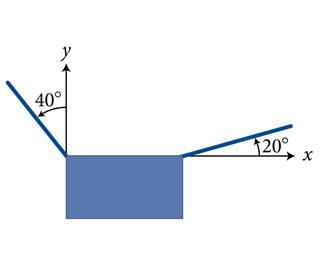

A sign is suspended by two wires as shown in the (Figure 1).
Is the tension in each wire larger than, equal to, or smaller than the gravitational force exerted on the sign by Earth?

The correct answer is the second one. I honestly have no idea why this is so. I understand that the right rope has less tension that the left one since it's at a shallower angle from real world experience, but I don't really know why this is so, let alone how the forces compare to gravitational force.
Did you try drawing a free body diagram and make an equilibrium analysis?
I would question your reasoning here.
Do what @Orodruin suggests. Label the two tensions and do a force analysis.
So create a free body diagram of all the forces acting on the block?

would there be three forces acting on the block, 2 forces pointing down, one to the right, and one to the left representing the left and right strings respectively, with the third force being gravity?
Yes. Three forces act on the block.
How would I tell their relation to gravity though?
Once you have your free body diagram, set up equations describing the forces acting on the box. Since the box in equilibrium, what must be the net force on it?
Net force would be zero right?
Yes.

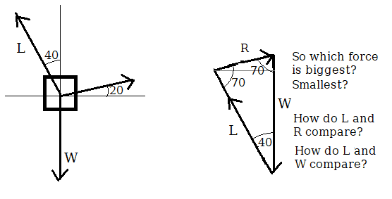

Sorry, what exactly do you mean by a triangle of forces? Should I separate the two tension forces into triangles, like a 50 40 90 triangle for the left wire, and a 20 90 and 70 triangle for the right?
Left is something like a Freebody diagram. Right is like a triangle of forces: a set of forces in equilibrium can be added (nose to tail) in a closed polygon. (Triangle really refers to slightly different process of adding two vectors to find a resultant. )
Ah, so from the right hand diagram I can see that L and W are equal in length and therefore equal in magnitude, and R is less than W, giving me the second answer. Thanks a lot!
Even if the result hadn't been so easy, the largest force is opposite the largest angle, the smallest force opposite the smallest angle.
If you need a numerical relation, then the lengths of the sides are proportional to the sine of the opposite angle.
