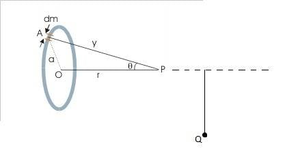

I am asked to calculate the gravitational potential of the ring at the point Q. I can do this for point P, but Q is killin me...
V = GM/r
M = ρ2∏a
dM = ρadθ
radius of ring = a
Well for the case at point P, it seems pretty straight forward:
dV = GdM/y
where y is the distance between the point and the edge of the ring. It's a fixed distance (so a constant)
Therefore, by integration:
V = G/y ∫dM (from 0 to M)
V = GM/y
However, for the case at point Q, I am baffled...
It seems to me that in this case y is no longer a constant, and therefore requires integration from the near side of the ring to the far side.
But how to express y? A hint would be wonderful...
I can only think as follows:
Create new angle ψ subtended by radii between the ring center, the "up" (12 o'clock) position on the ring, and another point along the ring (i.e. ignore θ).
Set up a cartesian coordinate system with the ring center at x=y=z=0, equation of ring being
x2 + z2 = a2 and give position of Q as Q(x,y,z=0) or Q(x=0,y,z), without loss of generality. So y points along the ring axis, x points up and z points to the left, looking at the ring from P.
The distance to be integrated d is now the distance between each ring segment and Q, i.e. a function of ψ, to appear in the denominator of your integrand. Note I have replaced your old y with a new parameter d since y is now part of the xyz coordinate system in which the ring is defined (the ring is at y = 0). The integral would be of the form ρaG∫dψ/d with limits ψ = 0 to ψ = 2π, and ρ is linear ring density, i.e. dM = aρdψ.
The expression for d promises to be messy! But decent tables should help. Hope I am making sense.

Set up a cartesian coordinate system with the ring center at x=y=z=0, and give position of Q as Q(x0,y0,z=0), without loss of generality. So y points along the ring axis towards P, x points up and z points to the right, looking at the ring from P.
The distance to be integrated d is now the distance between each ring segment and Q, i.e. a function of ψ, to appear in the denominator of your integrand. Note I have replaced your old y with a new parameter d since y is now part of the xyz coordinate system in which the ring and Q are defined (the ring is at y = 0). The integral would be of the form ρaG∫dψ/d with limits ψ = 0 to ψ = 2π, and ρ is linear ring density, i.e. dM = aρdψ.
d is the distance between a ring element at (acosψ, 0, asinψ) and Q(x0,y0,0) where x0 and y0 are of course constants.

Last shot: d of my Nov.29, 3:55 p.m. MST post is not that bad. It simplifies to the form
d = √{c - d*cos(ψ)}, c, d constants (functions of ring radius and position of Q).
Yeah, you're right... my idea would be close, but would be better at greater distances, and pretty bad at close distances.
I will try to work it out with your value for d. Thank you again, and everyone, for your help with this one. Sheesh!
That's right. Using half angle formulae and a bit of manipulation with lead to an elliptic integral of the first kind,
F(\theta|k^2) = \int_0^{\theta} \frac{d\phi}{\sqrt{1-k^2\sin^2\phi}}
That's the special function I was talking about.

OK, you probably noticed I used d twice in that expression for d. Inadvertently! So make the constants b and c instead of c and d. You shouldn't have any trouble identifying b and c with radius a and Q position coordinates x0 and y0, with z0 = 0 as before.
Wow, yeah I've never seen or heard of an elliptical integral, or that special function. I'm just a simpleton junior undergrad :p
I think the only special functions I've ever seen are Legendre Polynomials, and I just learned about them in my math methods class this semester. I might know more, but just aren't aware that they're called special functions.
The example my prof gave me to consider when solving this problem looked exactly like the point in the plane of the ring. I can solve that one, but then elevating that point really threw the whole class. None of us have seen or used elliptical integrals, so I kinda feel like this problem is beyond the level of this course...
And it was on our test...
