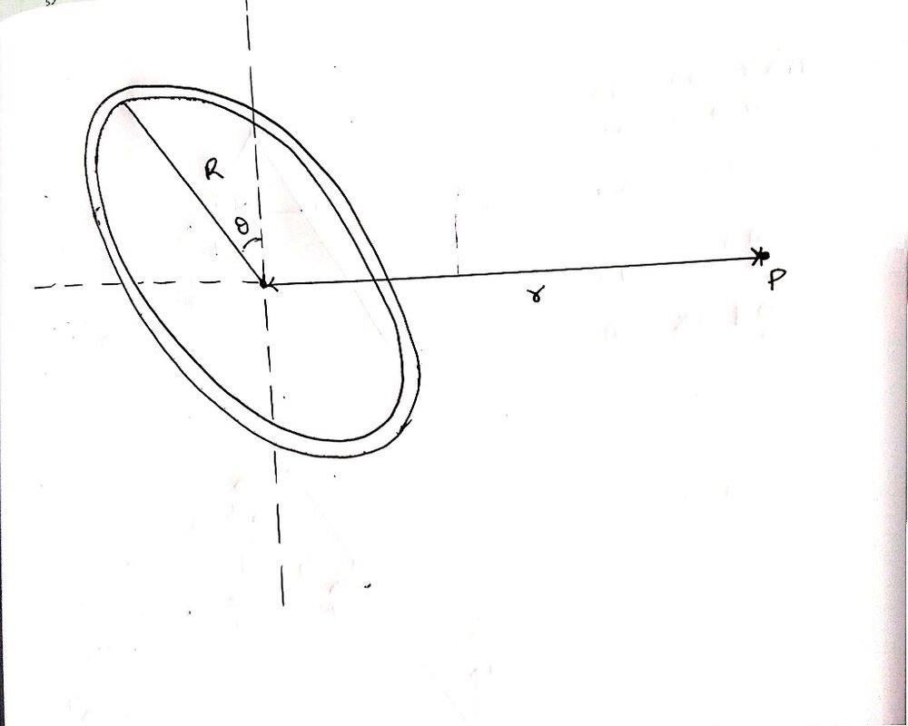

a uniform ring of mass M and radius R is tilted at an angle theta. find the gravitational potential at a point P at a distance r from the center of the ring.
gravitational potential = GM/r
I tried finding the potential due to a small element dM of the ring let's say dV, the summation of dV for all the dM's of the ring will give the potential at the point P, but since every element dM of the ring is at a different distance from the point P I am unable to come up with a differential equation to find the potential at P.
  • Hand-drawn diagram of a tilted circular ring with centre marked by a dot, radius R drawn from the centre to the rim, angle θ at the centre, a dashed axis, and a line of length r from the centre to a point P outside the ring.
You can take the ring as
[tex]x^2+y^2=R^2[/tex] or
[tex](x,y,z)=(R \cos\phi,R \sin\phi,0),\ 0<\phi<2\pi[/tex]
and P
[tex](P_x,P_y,P_z)=(r\sin\theta, 0, r \cos\theta)[/tex]
Then you can calculate the distance between.

Is it possible to obtain an algebraic expression? When I set it up, I ended up with an elliptic integral ?:)
In general an elliptic integral cannot be expressed in terms of elementary functions. The solution I found involved the elliptic integral of the first kind, ##F##. I might have made a mistake... so we should wait for a second opinion!

Try writing down potential using distance d in post #2 with integration via ##\phi## then you will find it.

here I think you have taken your coordinate system along the ring hence your can write the eq [tex]x^2+y^2=R^2[/tex]
I don't understand how you got
[tex](x,y,z)=(R \cos\phi,R \sin\phi,0),\ 0<\phi<2\pi[/tex] and what angle phi is over here.
if you write the coordinate of point p with origin at the center of the ring and the y-axis along the radii of the ring, how will
Py = 0
##\phi## is the angle around the ring from its intersection with the x-axis to an element of the ring of mass ##M\frac{d\phi}{2\pi}##.

y axis is chosen so that it is orthogonal to OP.
If we choose x-axis is orthogonal, ##P_x=0,P_y=r\sin\theta## instead.
i am unable to come up with an equation for a tilted circle
You don't need to find an equation for the tilted circle; you can just construct a new coordinate system ##\mathcal{F'} = \{O; \hat{x}', \hat{y}', \hat{z}'\}## with the same origin but just rotated so that the ring occupies a plane orthogonal to ##\hat{z}'##. Then you can just transform the coordinates of your point P into the new coordinate system (easiest with a diagram). That is what @anuttarasammyak did in #2.
If you really want to find the equation of a tilted circle, you could also try to look at it as the intersection of the sphere ##x^2 + y^2 + z^2 = R^2## and the plane defined by ##y=-\tan{(\theta)}x##. Or you could use a coordinate transformation.
Instead of a tilted circle and horizontal OP in your figure, in post #2 I take the flat ( or perpendicular ) circle and tilted OP to it by turning them by ##-\theta##.
