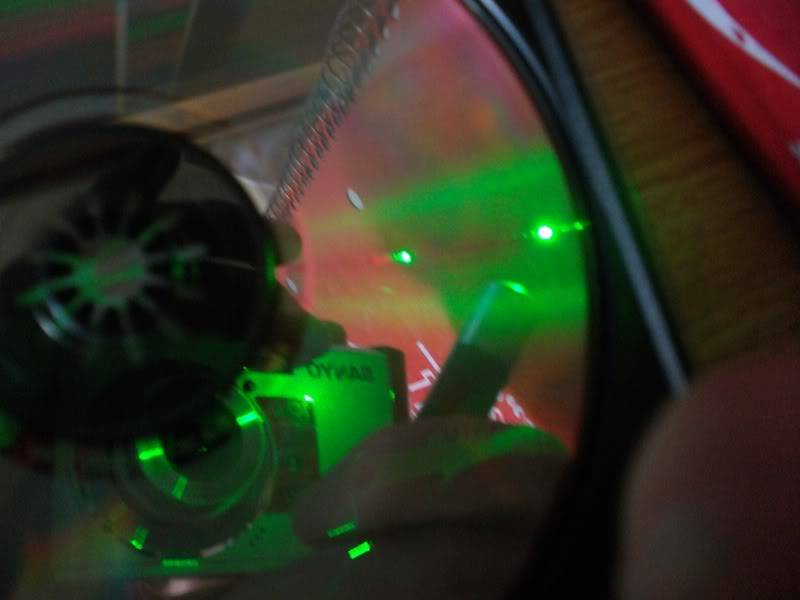

Update: I realized I could just use a CD to produce a spectrum. I shined the laser at the bottle again, and then I also used a red notebook as a control.
Here is the result:
Bottle:
Close-up photo of a compact disc held up to a camera lens, showing rainbow diffraction streaks and bright green and red spots reflected across its surface, with a red object at the top right.
Notebook:
Close photo of a green laser pointer shining onto a shiny, rainbow-tinted CD surface, with green laser dots and reflections visible on the disc and a red object in the upper right corner.
So yup it looks like the bottle is emitting yellow/red light when the green light is shined on it. There is a little bit of red light from the notebook too - I think that may just be reflected sunlight because it's not perfectly dark in my room.
