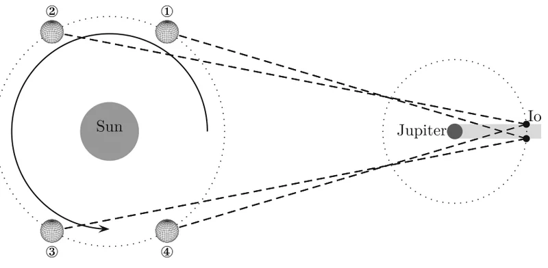

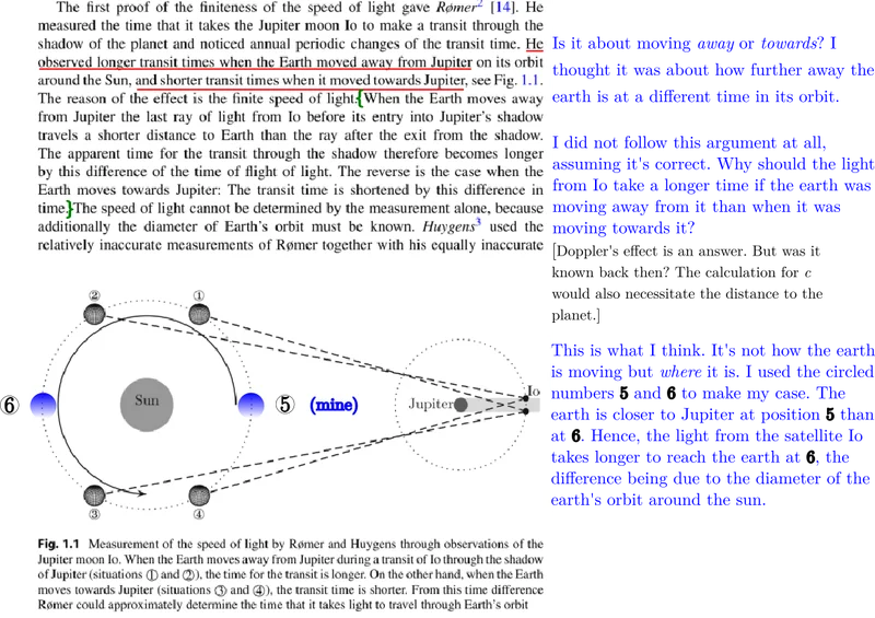

A recent textbook (see below) has described the dutch astronomer R##\ddot{\text o}##mer's calculation of the velocity of light by alluding to the differences in the sighting of Jupiter's moon when the earth was ##\textit{moving away}## from the planet as against the earth ##\textit{moving towards}## the planet. I don't understand it. Why should light take longer or shorter times depending how the earth moved? I thought it was due to ##\textit{where}## the earth is, not how it was moving.
Statement of the problem : I copy and paste the clip from the text, underling in red the sentences where, in my opinion, the author(s) have gone wrong. I annonate to the right of the text in blue, assuming they are both readable. The text in question is titled Special and General Relativity (2026, Springer) by Boblest, Muller and Wunner.
I don't explain further, except for one point.
It is reported that R##\ddot{\text o}##mer found a time lag ##\Delta t = 22\;\text{minutes}\,## between the two sightings of the moon at different times of the year. Also, that he found the light's speed to measure to about ##\boxed{c = 220,000\;\text{km/s}}##.
I can use my reasoning as in the image to see if it fits. If indeed the time discrepancy takes place due to where the earth is relative to Jupiter, then the "culprit" should be the diameter of the earth's orbit. It is this extra distance that light has to travel that explains why it appears that the moon Io's stays a longer time eclipsed "behind" Jupiter.
This should help me calculate. We know the radius of the earth's orbit around the sun ##R_{\bigodot} = 1.5\times 10^8\;\text{km}##. The reported time lag ##\Delta t = 22\; \text{minutes}\, = 22\times 60\; \text{seconds}\, ##. Hence the speed of light ##c = \dfrac{2R_{\bigodot}}{\Delta t}= \dfrac{2\times 1.5 \times 10^8\;\text{km}}{22\times 60\;\text{s}} = \boxed{227272\;\text{km/s}}##, which is close to what was obtained.
Thanks for your time. If indeed I am mistaken and the authors are correct, I'd like to know of their reasoning and the calculation. The only way out I can see is if light is assumed to move through ether. Indeed, according to Doppler's effect, the speed of light (or sound) will change if the observer moved towards or away from the source. Is this the author's reasoning? Even if it was, I don't see how it leads to the result of light speed.

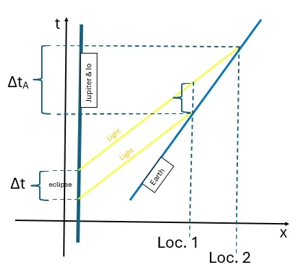

It's not about how the earth is moving. Rather it's about where the earth is, or so it seems.
The Doppler effect is why the eclipse timings vary, because the distance to Jupiter changes between the beginning and end of the eclipse. You don't use the Doppler effect to calculate the speed of light though, not least because the radial velocity of Jupiter is zero at conjunction and opposition.
An idealised version of Rømer's experiment is to place a clock on Jupiter and watch it through a telescope. You observe that the clock takes 0.999s to tick 1s (numbers made up), from which you deduce that Jupiter is 0.001 light seconds closer now than it was 1s ago. You observe that the clock takes 0.998s to tick the next second, so Jupiter is 0.002 light seconds closer than 1s ago, 0.003 light seconds closer than two seconds ago. You keep cumulating the (signed!) time difference like this between opposition and conjunction to get a total time difference. You attribute this time to the extra distance, the diameter of Earth's orbit, and deduce that the diameter is 22 light minutes (or 16 light minutes, with more precise measurements).
Edit: note that here I'm using "light second" to mean the as-yet-unknown distance that light travels in one second, so all you get is the same as Rømer got, an observation that whatever distance light travels in a minute, Earth's orbit is 22 times larger. You need a separate measurement to calibrate this in feet or whatever Rømer would have used.

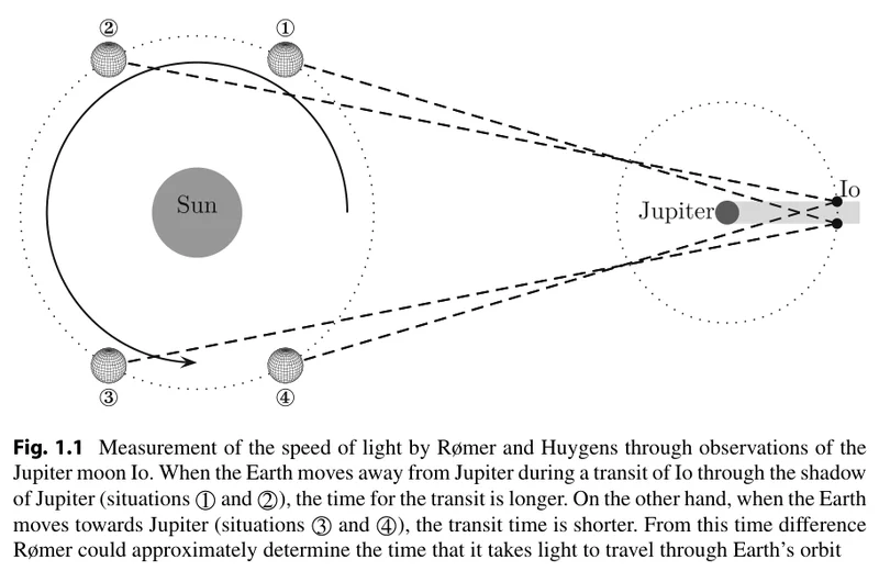

The text is clarified somewhat by the caption on the figure: "When the Earth moves away from Jupiter during a transit." I.e. it’s not the speed of the movement but rather the extent of the movement over the interval.
No, see the diagram the authors have drawn. There is no position difference between the labelled points 1 (and 2) and that between 3 (and 4) far as distance from Jupiter goes. According to the authors' reasoning, at 1 and 2, the earth is moving away from Jupiter and at 3 and 4, it was moving towards it. Which is true, but doesn't account for the time delay (discrepancy) in the observation of Jupiter's moon after it reappears following the eclipse.
The authors, far as I can see, are mistaken.

Are you saying it's the distance between 3 and 4 that matters? According to the authors, it's not the distance between 1 and 2, or between 3 and 4. They could be as close as you wish.
It's how the earth was moving at those points. Either towards or away from Jupiter.
The direction determines whether you see a lengthened or shortened eclipse. The speed (times the more-or-less constant duration of an eclipse) determines the difference in distance which determines the magnitude of the change. All that is wrapped up in the relative velocity of Earth and Jupiter.

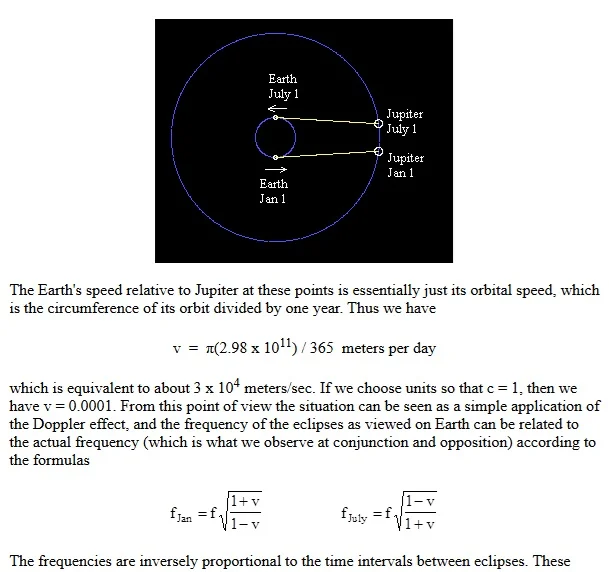

The following shows, that Roemer measured a Doppler-effect.
Source:
https://www.mathpages.com/home/kmath203/kmath203.htm

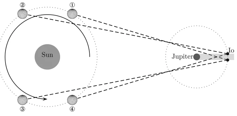

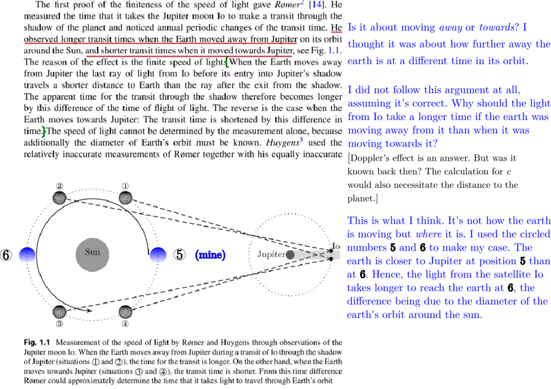

Let's have the image again.
It might be obvious from the picture, but let me state it all the same.
In 1 and 2, the object it moving away from Jupiter, while in 3 and 4, it is moving towards.
In 1 and 3, the moon Io is seen by the earth to be sliding out of the eclipse, while in 2 and 4 it is seen to be sliding into it.
Let's call the duration for the ellipse from ##1\rightarrow 2=\Delta t_{\text{A}}## (A for Away) and from ##3\rightarrow 4=\Delta t_{\text{T}}## (T for towards).
Are you saying that ##\Delta t_{\text A}>\Delta t_{\text T}##? And why? (Sorry I didn't follow your reasoning in the two posts above, at all).
Please correct me as I answer the question I raise myself.
If the speed of light is deemed constant irrespective of how the earth moves, we should have ##\Delta t_{\text A} = \Delta t_{\text T}##, for all four positions, and their means, are located at equal distances from Jupiter.

This is a diagram from the text. Imagine the earth was moving clockwise, instead of the anti-clockwise way it is in the picture. At 2 the moon Io slides into the eclipse and at 1 it slides out of it. How does this change the time period of the ellipse from what it was before, when the earth was rotating the other way?

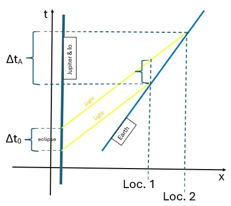

Call a time-interval near Jupiter (for example the duration of an eclipse) ##\Delta t_0## .
The distance between points ##1## and ##2## maybe called ##\Delta x##. Then, because light needs ##\Delta x / c## more time to point ##2## than to point ##1##:
##\Delta t_A = \Delta t_0+ \Delta x / c = \Delta t_0 + v\Delta t_A / c##
## 1 = \Delta t_0 / \Delta t_A + v/c##
##\Delta t_A / \Delta t_0 = {1 \over 1-v/c}##.
(see related diagram in posting #25)
This is the Doppler-formula, when the relativistic time-dilation factor ##1/\gamma## is neglected.
In the relativistic case (the signal speed in each frame is ##c##) you get the same Doppler formula as for the drawn frame if you draw a picture in which the Earth is at rest and Jupiter is moving.
Analog:
The distance between points ##3## and ##4## maybe called ##\Delta w##. Then, because light needs ##\Delta w / c## less time to point ##4## than to point ##3##:
##\Delta t_T = \Delta t_0 - \Delta w / c = \Delta t_0 - v\Delta t_T / c##
## 1 = \Delta t_0 / \Delta t_T - v/c##
##\Delta t_T / \Delta t_0 = {1 \over 1+v/c}##.

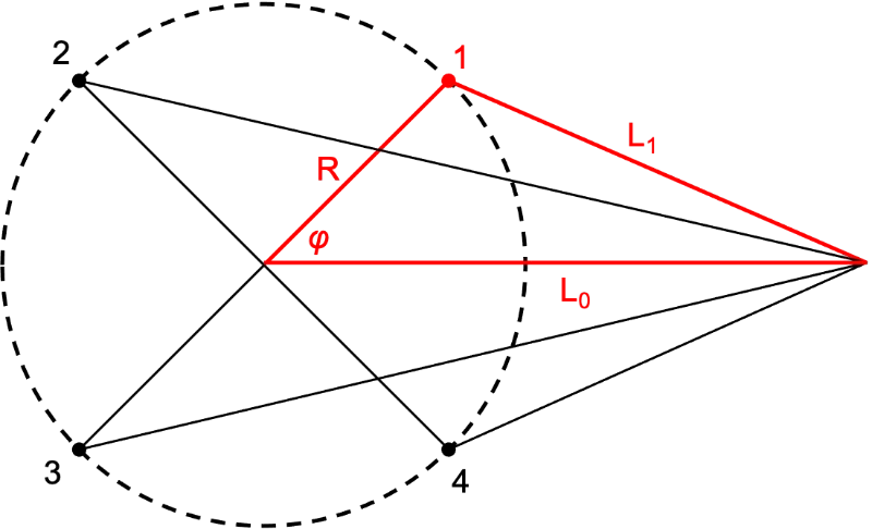

OK, here it is. The figure on the right is essentially a reproduction of the original figure. Subscripted distances ##L_i## denote the Earth-Jupiter distances assuming that Jupiter doesn't move. The fact that it actually moves with a period of about 12 years is irrelevant to the argument. Distance ##L_0## is the (fixed) Sun-Jupiter distance.
The dashed circle of radius ##R## is the orbit of the Earth around the Sun. We apply the Law of Cosines to the red triangle and get $$L_1=\sqrt{L_0^2+R^2-2RL_0\cos\varphi}.$$ Note that when ##\varphi=0##, ##L_1=L_0-R~## and when ##\varphi=\pi##, ##L_1=L_0+R~## as expected.
If ##\Delta t_1## is the time needed for light to travel from Jupiter to point 1, we have
##c~\Delta t_1=L_1=\sqrt{L_0^2+R^2-2RL_0\cos\varphi_1}.## Likewise,
##c~\Delta t_2=L_2=\sqrt{L_0^2+R^2-2RL_0\cos\varphi_2}.##
The difference between the two time intervals is
$$\Delta t_2-\Delta t_1=\frac{1}{c}\left(\sqrt{L_0^2+R^2-2RL_0\cos\varphi_2}-\sqrt{L_0^2+R^2-2RL_0\cos\varphi_1}\right).\tag{1}$$ Likewise for points 3 and 4, $$\Delta t_4-\Delta t_3=\frac{1}{c}\left(\sqrt{L_0^2+R^2-2RL_0\cos\varphi_4}-\sqrt{L_0^2+R^2-2RL_0\cos\varphi_3}\right).$$ From the diagram, $$\cos\varphi_4=\cos(\pi+\varphi_2)=-\cos\varphi_2~;~~\cos\varphi_3=\cos(\pi+\varphi_1)=-\cos\varphi_1$$so that $$\Delta t_4-\Delta t_3=\frac{1}{c}\left(\sqrt{L_0^2+R^2+2RL_0\cos\varphi_2}-\sqrt{L_0^2+R^2+2RL_0\cos\varphi_3}\right).\tag{2}$$If you compare equations (1) and (2), you see that the time differences when the Earth is receding and when is approaching are not the same because of the relative sign changes under the radicals.

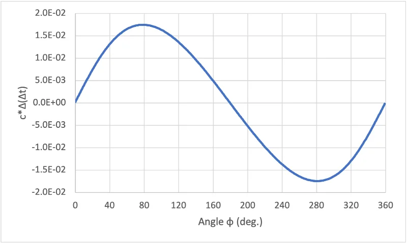

And here is a plot of ##c(\Delta t_{i+1}-\Delta t_i)~## as a function of ##\varphi## over a complete revolution of the Earth. To generate the plot, I used ##L_0=5.2~##A.U. and ##R=1~##A.U.

Bingo.
As should have been obvious, it would not have been possible to time an individual transit since that is defined as the period Io is invisible in consequence of Jupiter's shadow. From Earth, that can be observed at one end of the transit only; at the other, it will be hidden from Earth by Jupiter.
The book has it completely wrong. Your version is corroborated at https://en.wikipedia.org/wiki/Rømer%27s_determination_of_the_speed_of_light..
haruspex said:
… it would not have been possible to time an individual transit since that is defined as the period Io is invisible in consequence of Jupiter's shadow. From Earth, that can be observed at one end of the transit only; at the other, it will be hidden from Earth by Jupiter.
The radius of Jupiter at the equator is 71,500 km and the radius of Io’s orbit is 422,000 km. The radius of Jupiter’s orbit about the Sun is 5.2 AU. So the drawing is very misleading.
In order to see Io enter Jupiter’s shadow and then emerge you would have to be viewing it from the side. One would have work it out, but I expect it would be impossible to see both the beginning and end of an Io eclipse on both occasions 6 months apart.
So I think you are right that one could not be comparing duration of the eclipses. Rather it is the shift in start times of the eclipse that is being measured. That shift is a function of change in Jupiter’s position relative to the Sun and the change in distance between the Earth and Jupiter between observations.
AM
