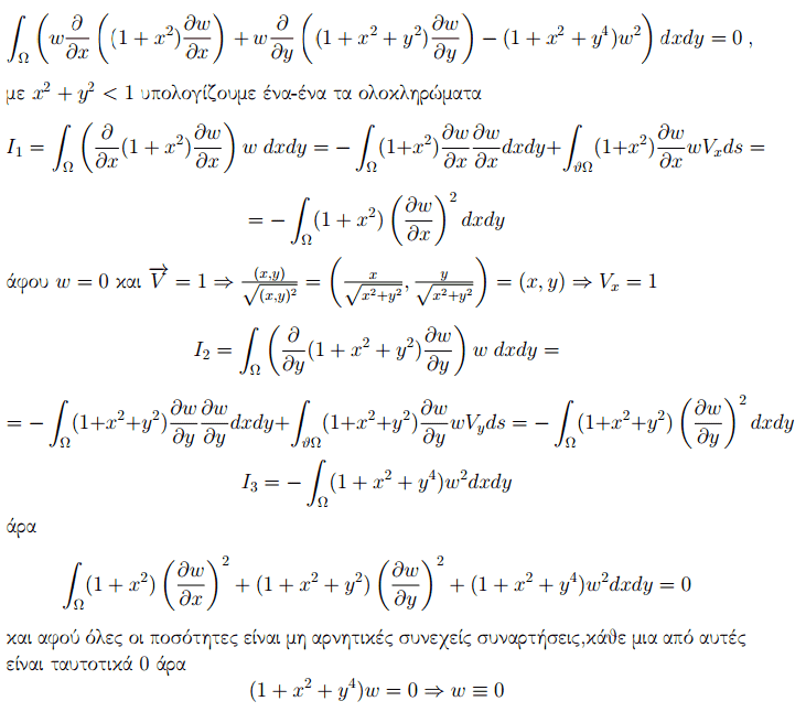

I found the following solution in my notes:
Could you explain to me the part where $V_x$ is used?? (Wondering)
Interesting! (Happy)
That's not Green's Theorem but Integration by parts in higher dimensions.
$V_x$ is supposed to be the x-component of the outward facing normal on the boundary, which I think should be $x$ instead of $1$. :eek:
