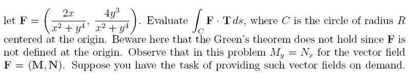

I have a problem from line integrals.
My question is attached as a jpeg.
Green's theorem is not valid for mine and i couldnot find a way.
Pls take care of it.
  • Typeset problem statement: F = (2x/(x^2+y^4), 4y^3/(x^2+y^4)). Evaluate the line integral of F dot T ds over circle C of radius R centred at the origin. Note Green's theorem does not hold since F is not defined at the origin; M_y = N_x for F = (M, N).
What does the last sentence mean?
Suppose you have the task of providing such vector fields on demand
It is just a clue. It goes on with saying this kind of functions can be created without much effort and asks how they are written.
And unfortunately i don't have much idea how to approach the problem.
I would say that the hint given is a big one indeed. It would save you a lot of computational effort if you understood it correctly. Have you learned about potential functions and conservative vector fields yet?
Actually, i predicted that but could not be sure. Than the answer is 0 since this is a conservative field and surface is a complete circle right?
Since Green's theorem does not work here, then you need to directly integrate around the circle. What parameterization can you use for a circle about the origin with radius r?
Yep, that should be it. Although it's more correct to say it's a line integral over a closed curve.
