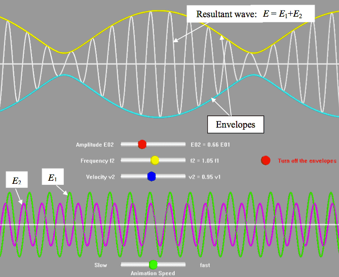

I've been working on a python simulation program that is based on phase velocity and group velocity. It looks like the following screenshot, where three parameters (E02, f2, and v2) can be adjusted. These three parameters are adjusted in terms of E01, f1, and v1.
Simulation screenshot of two superposed waves: a white resultant wave with yellow and cyan envelope curves, plus green and magenta component waves, with sliders for amplitude, frequency and velocity.

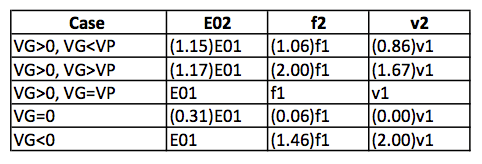

I adjusted the parameters for E_02, f2, and v2 to get the following cases:
Table with columns Case, E02, f2, v2 and five rows: VG>0 VG<VP (1.15)E01, (1.06)f1, (0.86)v1; VG>0 VG>VP (1.17)E01, (2.00)f1, (1.67)v1; VG>0 VG=VP E01, f1, v1; VG=0 (0.31)E01, (0.06)f1, (0.00)v1; VG<0 E01, (1.46)f1, (2.00)v1.
As a result of obtaining these arbitrary parameteres, I need to develop a theory that tells how to adjust these parameters E02, f2, v2 to get the group velocity designated in the cases above.

For the python simulation:
Group velocity is the velocity of the envelopes, phase velocity is the velocity of the resultant wave (white curve)
Positive velocity: Wave is moving from left to right
Negative velocity: Wave is moving from right to left
Observing the cases in the above table:
For VG = 0, it appears that the value for E02 and f2 does not matter as long as v2 = 0*v1 = 0.
For VG = VP, it is also knows the E02 = E01, f2=f1, and v2 = v1. So the parameters of one wave are equivalent to the parameters of the other wave.
At this point, I'm a little lost. My TA says that there is an equation to be derived so that I can obtain the above cases by inputting certain values to it. I don't know where to go from here to obtain that equation. Will someone please help me? I'd highly appreciate it.
  • Simulation screenshot of two superposed waves: a white resultant wave with yellow and cyan envelope curves, a grey panel with sliders for amplitude E02, frequency f2 and velocity v2, and green and magenta component waves labelled E1 and E2.

  • Table with columns Case, E02, f2, v2 listing five cases: VG>0 VG<VP, VG>0 VG>VP, VG>0 VG=VP, VG=0, VG<0, with entries such as (1.15)E01, (1.06)f1, (0.86)v1 and (0.31)E01.
