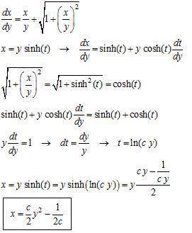

Hi !
Let x = y sinh(t)
dx/dy = sinh(t) + y cosh(t) (dt/dy)
which leads to a very simple ODE

sinh(ln(c*y)) = (c*y-(1/(c*y))/2
So, there is no hyperbolic function, nor trigonometric function, in the final result : x = function of y , which is a very simple parabolic function.

Hi !
if you know an easier way... :devil:
  • Handwritten derivation solving a differential equation by substitution x = y sinh(t), with steps reducing to t = ln(cy) and boxed final answer x = (c/2)y^2 - 1/(2c).
