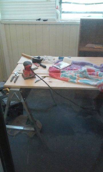

I did this all in our sun room which is a small space but just large enough for a couple of saw bucks and my power tools. I used a Jigsaw, a circular saw, a hand drill, a wood router, and an elliptical sander "jitter bug". Hand tools: combination square, carpenters square, calipers, tape measure hammer nail punch putty knife, utility knife, pliers, screwdrivers

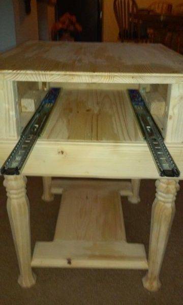

I first constructed the base for the cabinet and framed it with the 3 1/2'' pine and routed a beveled edge on both sides for trim work. Using finishing nails and 5/16" dowel rod.
I then attached the legs to the base, using (4) L brackets and 1/2" long screws glue and 3/8" dowel rod. I also put a finishing nail and long wood screw through the top of the base. Problem, That's when I realized they would be much to tall and there was and an error in calculation, Solution (got out the pen and paper and did some refiguring) and the balls on the end of the legs were just the right length to remove and make them the right height. Since the legs were machined and segmented unless you seen the legs as they were as one whole piece, you'd never know the difference.
After securing the legs I built the cabinet separate with the 1 1/2'' x 1 1/2'' supports and the 5 1/2'' pine. I cut 2 more pieces of 1/12'' x 1 1/2'' stock 2 1/2 '' long to add horizontally at the bottom of the cabinet to help attach it and act as (guide for the drawer) then used (4) L brackets to attach the cabinet to the base along with glue and dowel rod.

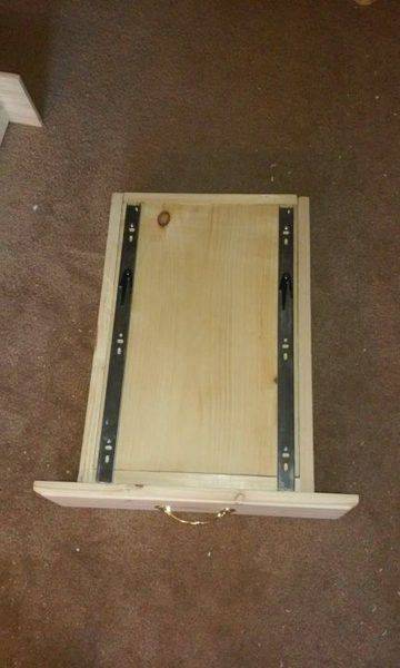

I then built the drawer out of the 11 1/2'' and framed it with the 3 1/2'' pieces of pine. I then attached the drawer glides to the base and mounted the drawer to the glides. After fitting I took the 20'' x 17 3/8'' x 5 1/2'' piece and routed a beveled edge around the piece for the drawer face then clamped and glued to the drawer. then I measured for the center from top to bottom and side to side...the handles are 3'' on center from the middle of the drawer. (The trick, locate and mount the glides to the drawer first, put the drawer in the cabinet and pull the slide out to the first screw hole...I used pennies as spacers once I knew the drawer was straight I pulled it out to the next mounting point). Easy peasy.

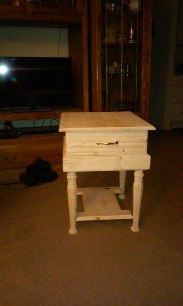

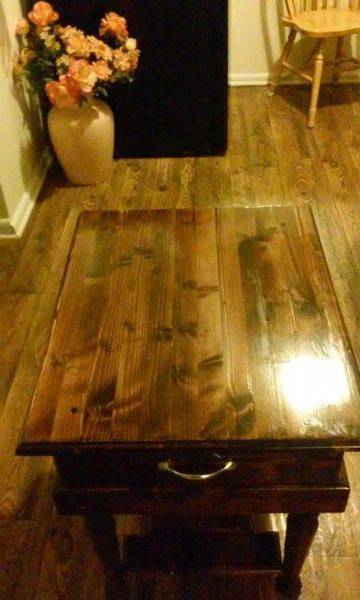

Finally I mount the table top, I just center it on the drawer cabinet and finish nailed and glued it in place, I then located the center of each of the cabinet supports and drilled 3/8'' dowel pegs to secure it. Then I routed the beveled edge on top.
The finishing touch: I took the left over 3 1/2'' pieces and some 9 12'' x 3/4'' long pine scrap I had and made a magazine shelf in the shape of an capital "I" with the grain running in 2 different directions I dowel pegged and glued those pieces together then beveled them also. I attached them to the legs located 3'' from the floor, Tip (when working with wood making tables if the legs are "splayed" and things are a little out of square adding trim or a magazine shelf can square it up for you plus its a nice decorative touch with a purpose.) I'll add more pictures after staining and poly.

The staining happens tonight.:smile:

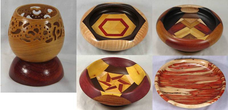

Me too.

Wow...nice colorful work. Very detailed as well.
drawer and hardware...wiping them down for staining now.

Will do phinds. Btw i love the intricate carving on that first peice...got to have skill and precision to do that...well done!

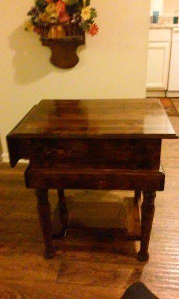

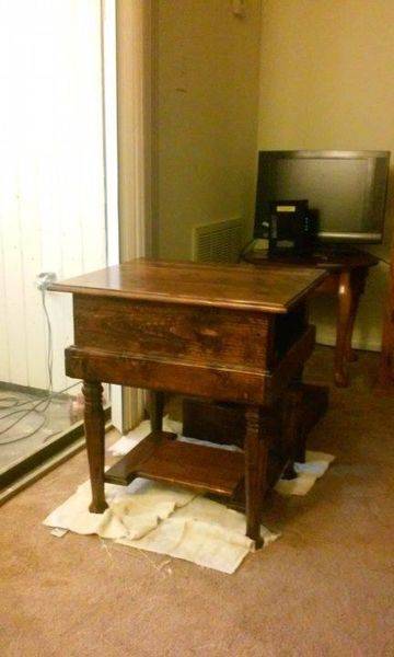

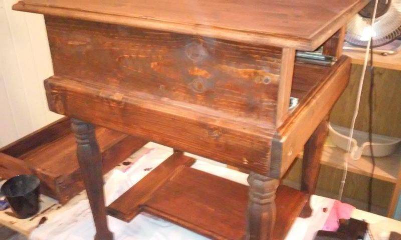

One stained one to go...i,ll post both pieces when they are complete
You will notice the legs are a bit darker then the rest. Its actually a different wood and its very porous...Tip you can use a solvent to lighten stain. I used googone but you can uae alcohol, acetone or lacquer thinner to lighten stain. Or you can thin up your stain before application. There is also a woodworkers trick called "doping" 3 parts water and one part wood glue...simply whipe on the porous material or end grain and let dry, it won't absorb as much stain. :smile:

Thanks, but it's actually probably a bit more random than you think for most of them. Over time I just figured out what works well and what doesn't. A lot of it is just trial and error.

Actually I used way more than what's pictured, for some reason they all wouldn't up load.
