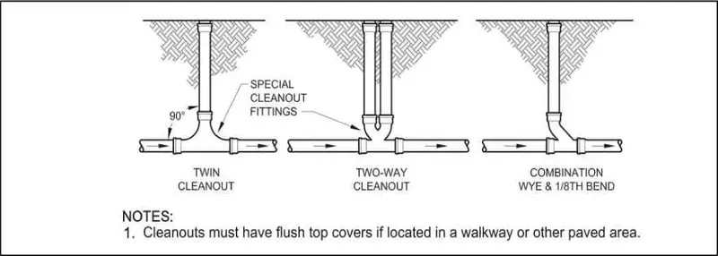

The 3-inch sanitary drain clean-out port is normally located at grade level, as close to the exterior wall as possible, in order to reach farther into the house, but not closer than one foot, so the plumbing snake can be easily fed also into the sewer main direction (commonly, there is a 2-way tee connecting the clean-out vertical pipe and the underground drain pipe).
Please, see:
https://up.codes/s/cleanouts-for-drain-piping

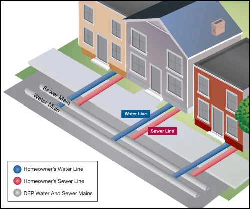

Regarding location of underground water supply, storm and sewer main pipes, could the underground layout be like this?
Yes. The underground layout of my sewer line and water line could be like that. Indeed, I think that the underground layout of my sewer line and water line is probably like that.
