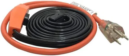

I had two Belgian rabbits. When I started using the copper pipe, they were about 1 years old. One lived to ten, the other to twelve - both longer than average. They did not attempt to gnaw at that pipe. Also, the pipe was not in direct contact with their water. The water bowl was metal - as I recall, stainless steel. I used metal clad cable to get power from outside the cage to the heating unit.
I made sure that the copper pipe I bought was wide enough to hold that somewhat bulky thermostat. Then I ran that pipe on the floor of the enclosed part of the wooden bunny cage, along the walls.
That Frost King heater will put out 7 Watts per foot. As I recall, the one I used was just 3 feet. But they have a 6-foot version (42 Watts).

Home depot sells that Frost King pipe heater (with preset thermostat) for about $23 for the 3' and 12' version and $20 for the 6' version. That's the one I pictured above. Under normal use, they are rated to keep water flowing through a 2" copper pipe down to -40F. That black pad on the side of the thermostat is suppose to be flush to the pipe. For my purposes, it was flush to the inside of the pipe.
What that meant in my case is that I spent more on the copper pipe than I did for a nicely sealed up thermostat and heating element combination that, except for the unarmored cord, was an ideal match for my bunny application.
