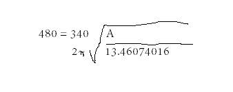

Helmholtz resonator equation. How do I do this?? Please help.
L = 0
Vo = 473.17 (I think its cubed though I calculated it from 16 ounces, so I should be cubed right??)
A = What I am solving for
F = 480 hz
V= speed of sound which is 340.19 at sea level
If Vo needs to be cubed then A should be squared, but I don't know if I am supposed to do that
Ive put all this down on paper and I am not sure how to run this equation to solve especially when it comes to the square root of a fraction, especially if the fraction is cubed and squared.
How do I do this? Been searching the internet for 2 days now trying to figure this out.

Here's how you may do it:
1. NEVER insert numbers until your last step, solve it algebraically!
2. We have:
f_{H}=\frac{v}{2\pi}\sqrt{\frac{A}{V_{0}L}}
We multiply with 2pi/v, gaining:
\sqrt{\frac{A}{V_{0}L}}=\frac{2\pi{f}_{H}}{v}
We square both sides,
\frac{A}{V_{0}L}=\frac{4\pi^{2}{f}^{2}_{H}}{v^{2}}
We multiply with V_{0}L, and gain:
A=V_{0}L\frac{4\pi^{2}{f}^{2}_{H}}{v^{2}}
3. NOW, insert numbers to calculate A!

If you just plug in the numbers, as you did in post #11, you will get the wrong answer because your units won't match.
Ok I did 240 hertz instead, so an octave lower, and got 1033.4 that looks a bit better.
So basically if what I have come up with is 9cm will give 120herts and 4.5 will give 60hertz.
Just to be sure, the speed of sound need to be converted to the same units that I am using for the resonator correct? In this case, centimeters
Well, to get the simplest correct expression, you should use the SAME scales for the same type of units.
For example, 10 meters divided by 20 centimeters equals 10m/(20cm)=0.5 m/(cm).
A rather simpler expression is to remember that 1 meter=100 cm, so that 0.5 m(cm)=0.5*100(cm)/(cm)=50
