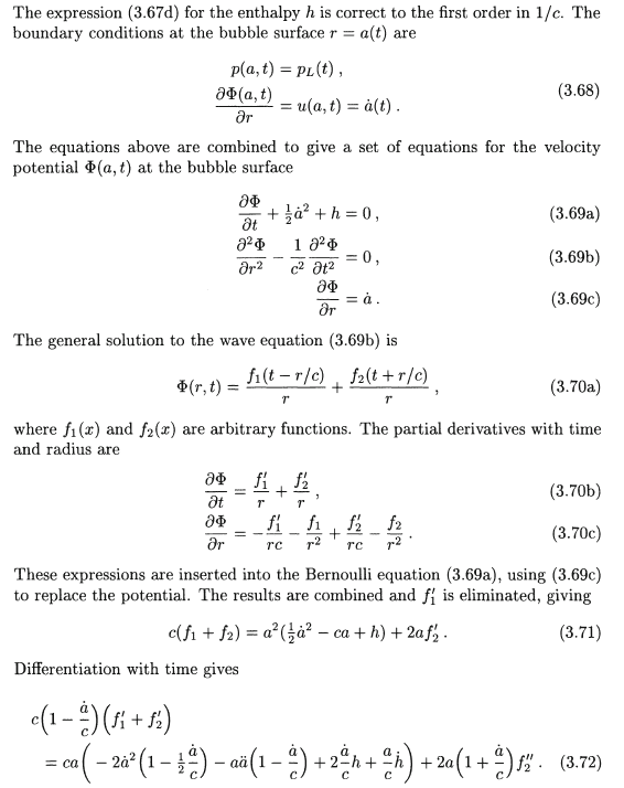

I came across these equations in a mechanics textbook and wish to differentiate the first equation w.r.t. time to obtain that second equation. Any help is much appreciated!
$$c(f_1+f_2)=a^2(\frac{1}{2}\dot{a}^2 -ca+h)+2af'_2$$
$$c(1-\frac{\dot{a}}{c})(f'_1+f'_2)=ca(-2\dot{a}^2 (1-\frac{1}{2}\frac{\dot{a}}{c})-a\ddot{a}(1-\frac{\dot{a}}{c})+2\frac{\dot{a}}{c}h+\frac{a}{c}\dot{h})+2a(1+\frac{\dot{a}}{c}){f''_2}$$
##f_1(x)=f_1(t-\frac{r}{c})##, ##f_2(x)=f_2(t+\frac{r}{c})##
The book didn't explicitly state the functions of time, but from the second equation we can see that ##a## and ##h## are functions of time.
We also know that $$\frac{f'_1+f'_2}{a}+\frac{1}{2}\dot{a}^2+h=0$$ (if that's of any help)
Please see above
I tried doing it a few times and this is all I get:
c(˙f1+˙f2)=a˙a2+a2˙a−3ca2+˙ha2+2ha+2˙af′2+2a˙f′2c(f1˙+f2˙)=aa˙2+a2a˙−3ca2+h˙a2+2ha+2a˙f2′+2af2′˙​
Please let me know where I'm going wrong. Thanks

I've attached the page that I am trying to understand. You are right, ##f_1## and ##f_2## are indeed functions of ##x_1## and ##x_2## respectively (see equation 3.71a in the page attached).
I am still however having a hard time to obtain their equation (3.72).

Consider the left side of the equation $$c(f_1+f_2)=a^2(\frac{1}{2}\dot{a}^2 -ca+h)+2af'_2$$
What do you get for the time derivative of ##c(f_1+f_2)##? Express the result in terms of ##f'_1, f'_2, \dot a##, and ##c##.

##\dot{f_1}=f'_1(1-\frac{\dot{a}}{c})## and ##\dot{f_2}=f'_2(1+\frac{\dot{a}}{c})##
Good. I think you should be able to complete it. On the right hand side there is the term ##2af'_2##. What's the time derivative of this term?

The derivative of ##2af'_2## wrt time is ##2\dot{a}f'_2+2a\dot{f'_2}##, but I'm not sure how to express ##\dot{f'_2}## in terms of ##\dot{a}##, ##c## and ##f'##.
##f'_2## is just another function of ##x_2##. So, you can use the chain rule to get ##\dot {f'_2}## just like you did when finding ##\dot {f_2}##.

So I think I'm almost there, but now I'm having a problem with differentiating the the first term on the RHS (##a^2(\frac{1}{2}\dot{a}^2-ca+h)##) with respect to time. This is what I got after differentiating this term:
##a\dot{a}^3+a^2\dot{a}\ddot{a}-3c{a}^2\dot{a}+\dot{h}a^2+2ha\dot{a}##
It seems to be different from what they got, and I am not sure where I went wrong.

Thanks! Now so I tried differentiating the the first term on the RHS (##a^2(\frac{1}{2}\dot{a}^2-ca+h)##) with respect to time. This is what I got after differentiating this term:
Please show us the relation between a and r in OP. Then try calculating time derivative of the rest of RHS,

So I tried calculating the derivative now and I'm getting most of the terms (LHS of the equation and the 3 right most terms of the RHS). This is what I have now:
##c(1-\frac{\dot{a}}{c})(f'_1+f'_2)=ca(\frac{\dot{a}^3}{c}+\frac{a\dot{a}\ddot{a}}{c}-3a\dot{a}+\frac{2\dot{a}h}{c}+a\frac{\dot{h}}{c})+2af''_2(1+\frac{\dot{a}}{c})##
I am still trying to figure out the 3 left most terms on the RHS

Ya I just did that. It seems like I'm almost arriving at their expression but I can't seem to get the 2 first terms on the RHS.
##\frac{d}{dt}(a^2(\frac{1}{2}\dot{a}^2-ca)=ca(-2\dot{a}^2(1-\frac{1}{2}\frac{\dot{a}}{c})-a\ddot{a}(1-\frac{\dot{a}}{c}))##
I am not sure how they arrived at that. This is what I keep getting:
##\frac{d}{dt}(a^2(\frac{1}{2}\dot{a}^2-ca)=a\dot{a}^3+a^2\dot{a}\ddot{a}-3ca^2\dot{a}##

I should have checked more carefully.
Note that in the equation
the first and second terms inside the parentheses on the RHS do not match dimensionally. I suspect that there is a typographical error and the middle term should actually be ##-c\dot a## instead of ##-ca##. So the equation should be
Then, I believe that taking the time derivative of this will lead to the result as given in the text.

Thank you so so much! I really appreciate all your help. It finally worked :)
